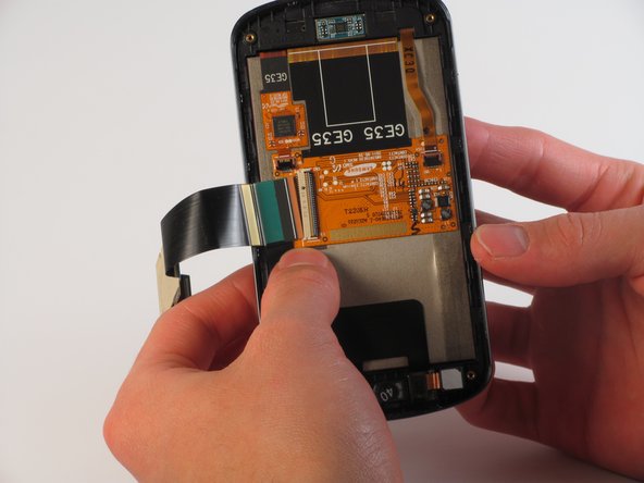

  18. Samsung Stratosphere Flex Cable Replacement, Flex Cable: passo 18, immagine 1 di 1
    • Carefully peel the blue tape from the bottom of the flex cable and set it aside.
  19. Samsung Stratosphere Flex Cable Replacement: passo 19, immagine 1 di 2 Samsung Stratosphere Flex Cable Replacement: passo 19, immagine 2 di 2
    • Use one of the plastic opening tools to loosen the flex cable from its central housing.
    • Pull lightly on the flex cable to free it from the housing.
    • The cable may audibly snap as it is freed from its attachment.
  20. Samsung Stratosphere Flex Cable Replacement: passo 20, immagine 1 di 1
    Attrezzo utilizzato in questo passaggio:
    • Use tweezers to loosen the flex cable and speaker from the bottom of the phone.
    • Pull upward with the tweezers and the flex cable will come loose.
    • The flex cable will come free with the front-facing camera attached. In order to remove the front-facing camera, see our guide here.
