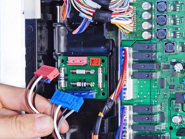

  4. Samsung Refrigerator Fuse Block Replacement, Remove the fuse block: passo 4, immagine 1 di 3 Samsung Refrigerator Fuse Block Replacement, Remove the fuse block: passo 4, immagine 2 di 3 Samsung Refrigerator Fuse Block Replacement, Remove the fuse block: passo 4, immagine 3 di 3
    • Squeeze the wide sides of the red connector to unlatch it from the fuse block.
    • Pull to disconnect the connector.
    • Repeat the procedure to disconnect the blue connector.
    • During reassembly, make sure the connectors lock in place. If they don't, you may need to flip their orientation.

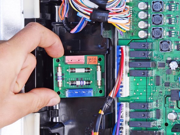

  5. Samsung Refrigerator Fuse Block Replacement: passo 5, immagine 1 di 3 Samsung Refrigerator Fuse Block Replacement: passo 5, immagine 2 di 3 Samsung Refrigerator Fuse Block Replacement: passo 5, immagine 3 di 3
    • Use your fingers to pry and release the black plastic clip holding the left edge of the fuse block.
    • Lift out and remove the fuse block.
