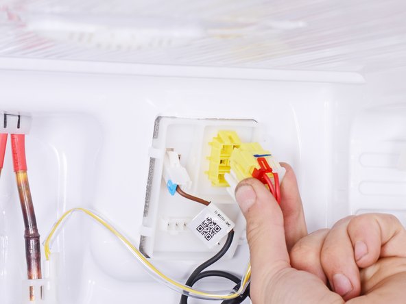

  12. Samsung Refrigerator Freezer Evaporator Components Replacement: passo 12, immagine 1 di 2 Samsung Refrigerator Freezer Evaporator Components Replacement: passo 12, immagine 2 di 2
    • Use your fingers to squeeze and disconnect the harness connector from the refrigerator.
  13. Samsung Refrigerator Freezer Evaporator Components Replacement: passo 13, immagine 1 di 3 Samsung Refrigerator Freezer Evaporator Components Replacement: passo 13, immagine 2 di 3 Samsung Refrigerator Freezer Evaporator Components Replacement: passo 13, immagine 3 di 3
    • Use your fingers to pry and remove the red and white connector retaining clips from the harness connector. This will separate the connector into three individual connectors.
    • The three connectors are stacked on top of each other. The order from top to bottom is:
    • Defrost coil thermal fuse (yellow connector with two red wires)
    • One end of the defrost coil (yellow connector with brown wire in the left pin)
    • Evaporator coil thermistor (white connector with two yellow wires)

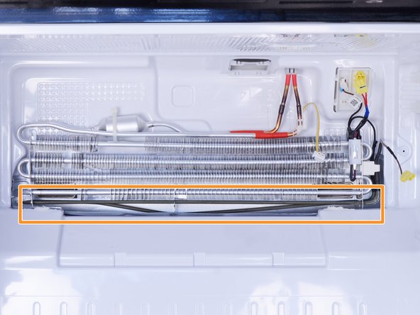

    • The freezer evaporator system includes these components:
    • Evaporator coil (filled with refrigerant and is non-removable)
    • Defrost heater
    • Evaporator coil thermister
    • Depending on your repair, remove and replace the affected components.
