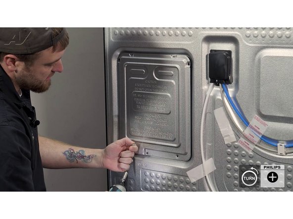

  2. Samsung RF28R7351 Fuse Block Module Replacement: passo 2, immagine 1 di 1
    • You will need a Phillips screwdriver to remove the cover, which is held on by five Phillips screws.
    • Remove the five Phillips screws.
    • The lower middle screw is a machine screw thread, so keep it separate for reinstallation.

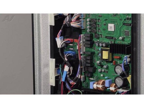

  3. Samsung RF28R7351 Fuse Block Module Replacement: passo 4, immagine 1 di 2 Samsung RF28R7351 Fuse Block Module Replacement: passo 4, immagine 2 di 2
    • With the panel removed, you now have clear access to the fuse block.
  4. Samsung RF28R7351 Fuse Block Module Replacement, Test continuity of fuses: passo 5, immagine 1 di 2 Samsung RF28R7351 Fuse Block Module Replacement, Test continuity of fuses: passo 5, immagine 2 di 2
    • The main reason why you'd be accessing your fuse block is if the unit has no power
    • Once the fuse block is removed, you can use your multimeter to test continuity on the metal sides of each one of these fuses.
    • (How to use a multimeter)
    • If one is blown, the fuse block will need to be replaced.
