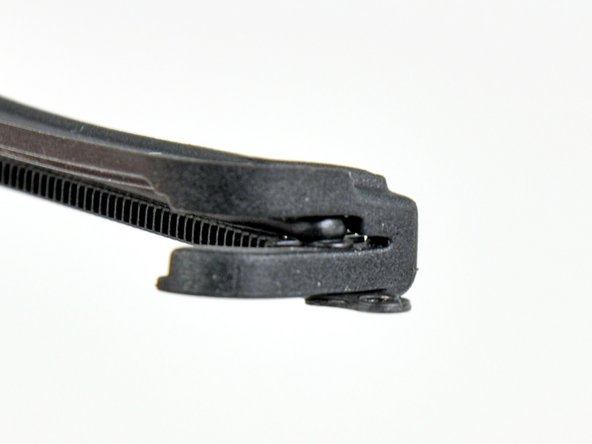

  17. MacBook Air 13" Mid 2012 Heat Sink Replacement, Heat Sink: passo 17, immagine 1 di 1
    • Remove the two 4.9 mm T8 Torx screws securing the antenna cable retainer on the left display hinge to the upper case.
  18. MacBook Air 13" Mid 2012 Heat Sink Replacement: passo 18, immagine 1 di 1
    • Push the antenna cable retainer out of the way and remove the 3 mm T5 Torx screw securing the end of the heat sink to the upper case.

  21. MacBook Air 13" Mid 2012 Heat Sink Replacement: passo 21, immagine 1 di 2 MacBook Air 13" Mid 2012 Heat Sink Replacement: passo 21, immagine 2 di 2
    • These shots show how the rubber fan gasket should be installed during reassembly. Be sure not to install the gasket underneath the ear where the end of the heatsink is screwed down to the upper case.
    • Additionally, be sure the small post molded into the rubber gasket mates with the hole cut into the upper right corner of the logic board.
