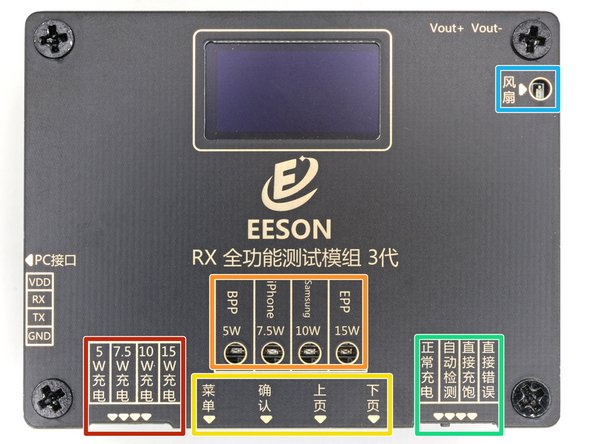

  1. How to use the EESON Wireless Charger Tester, Hardware overview: passo 1, immagine 1 di 2 How to use the EESON Wireless Charger Tester, Hardware overview: passo 1, immagine 2 di 2
    • Here's an overview of the indicators and switches on the tester:
    • Test type selector
    • Test type indicator
    • Screen menu buttons
    • Test mode selector
    • Cooling fan indicator LED
    • Error indicator LED

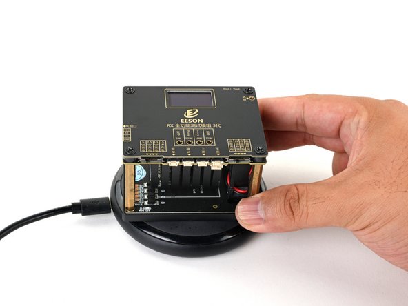

  3. How to use the EESON Wireless Charger Tester: passo 3, immagine 1 di 2 How to use the EESON Wireless Charger Tester: passo 3, immagine 2 di 2
    • Place the tester on the wireless charging pad.
    • The tester will power on and the screen will show the following details:
    • Test type—don't mind if it says "FAIL". This just means that the charging pad wasn't able to source up to 15W.
    • Voltage, current, and wattage received by the tester
    • Power feedback—deals with how the resonance field changes. This will change if you move the charging coils, but should stay at +0.
    • Elapsed test time
    • Transmission frequency
