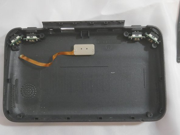

  4. GPD Win Battery Replacement: passo 4, immagine 1 di 3 GPD Win Battery Replacement: passo 4, immagine 2 di 3 GPD Win Battery Replacement: passo 4, immagine 3 di 3
    • Carefully insert the pry tool between the keyboard and case.
    • Move the tool around the edge until every clip is released.
    • Carefully lift the back half of the case.
    • You'll see a small ribbon connector on the right. Use your pry tool to remove it by lifting up.
    • On the right, you'll see another white connector going to the battery. Use the pry tool and pull back on the connector to release it.

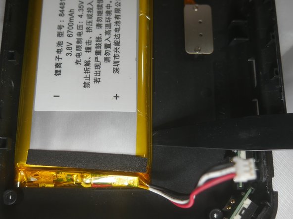

  5. GPD Win Battery Replacement: passo 5, immagine 1 di 3 GPD Win Battery Replacement: passo 5, immagine 2 di 3 GPD Win Battery Replacement: passo 5, immagine 3 di 3
    • Separate the two halves of the device.
    • Use the pry tool and slowly and carefully separate the adhesive from the back of the case.
    • Remove old battery.

At the moment, the Shenzhen Zero Five Battery Company replacement comes with two wires crossed. You'll need a small metal pick to pry the clips open enough to pull the conductors out and swap them over. It should be red, yellow, black. I've performed the modification and can confirm it works after switching the contacts.
