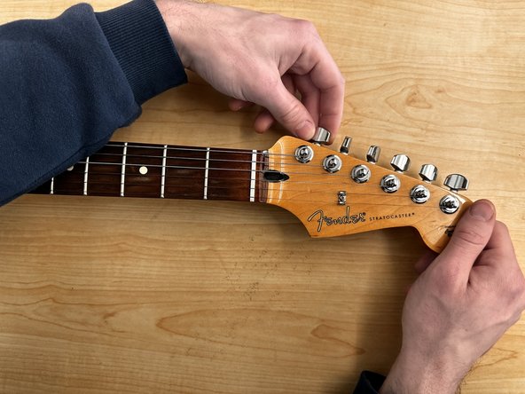

  1. Fender Stratocaster Volume Potentiometer Replacement, Fender Stratocaster Volume Potentiometer: passo 1, immagine 1 di 3 Fender Stratocaster Volume Potentiometer Replacement, Fender Stratocaster Volume Potentiometer: passo 1, immagine 2 di 3 Fender Stratocaster Volume Potentiometer Replacement, Fender Stratocaster Volume Potentiometer: passo 1, immagine 3 di 3

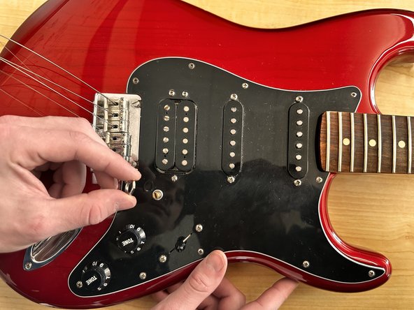

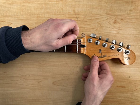

    • Loosen the low E string of the guitar by turning it's tuning peg in the clockwise direction.
    • Once completely loosened, pull the string out of its tuning post.
    • Repeat the previous two bullets for the rest of the strings.

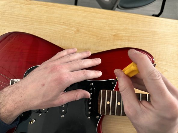

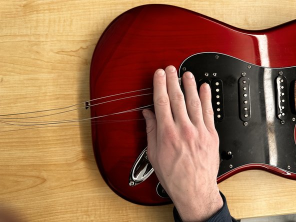

    • After pulling out all of the strings from their tuning pegs, grab them and fold them over the bottom of the guitar.

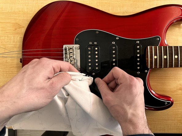

  3. Fender Stratocaster Volume Potentiometer Replacement: passo 3, immagine 1 di 3 Fender Stratocaster Volume Potentiometer Replacement: passo 3, immagine 2 di 3 Fender Stratocaster Volume Potentiometer Replacement: passo 3, immagine 3 di 3

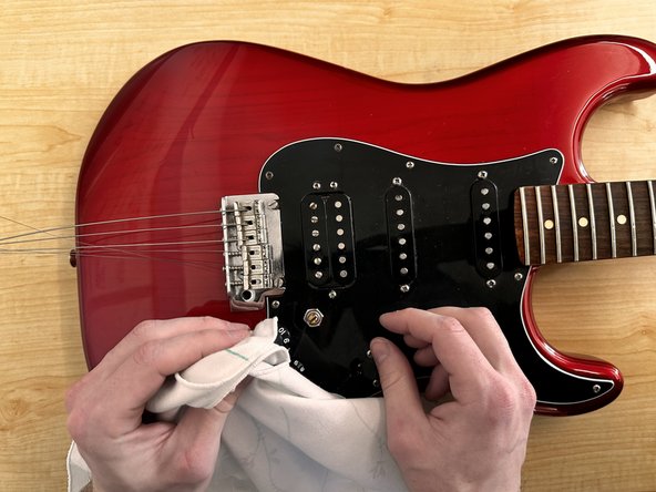

    • Take a cloth and slip it underneath one end of the volume knob.
    • Wrap the cloth around the rest of the knob such that it makes contact with most of the knob's underside.
    • Once the cloth is fully secured, grab it right above the knob and pull straight up.
    • The knob should easily pop off.

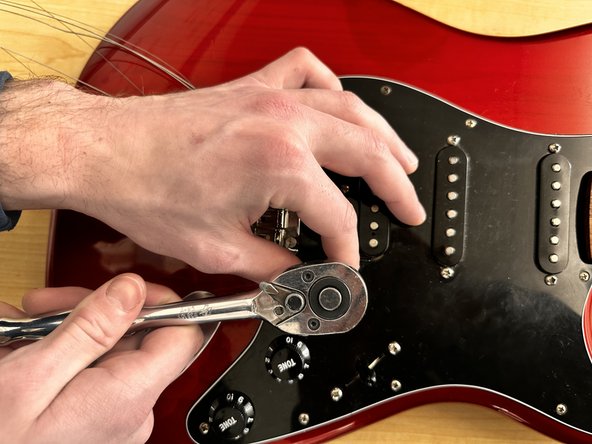

  4. Fender Stratocaster Volume Potentiometer Replacement: passo 4, immagine 1 di 3 Fender Stratocaster Volume Potentiometer Replacement: passo 4, immagine 2 di 3 Fender Stratocaster Volume Potentiometer Replacement: passo 4, immagine 3 di 3
    • Take the socket wrench and place it onto the mounting nut.
    • Loosen the mounting nut and then take it off.

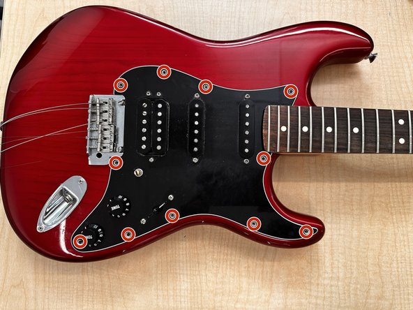

    • Use a Phillips screwdriver to remove all of the screws on the perimeter of the pickguard.
    • You should end up with a total of 11 screws.

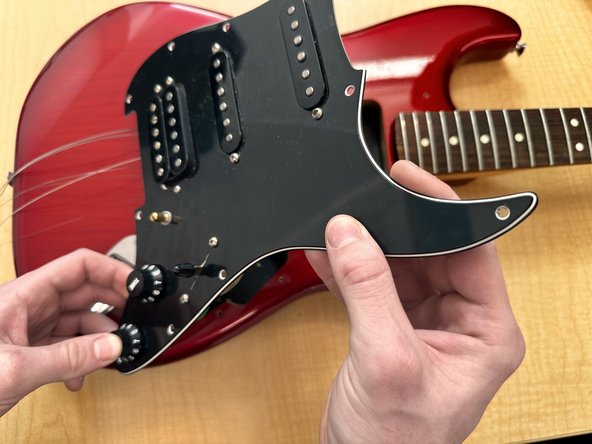

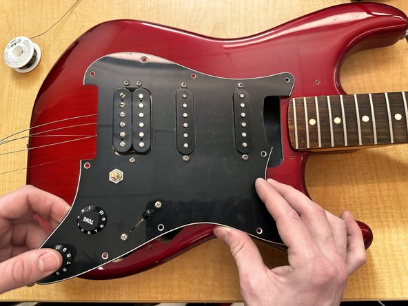

  6. Fender Stratocaster Volume Potentiometer Replacement: passo 6, immagine 1 di 3 Fender Stratocaster Volume Potentiometer Replacement: passo 6, immagine 2 di 3 Fender Stratocaster Volume Potentiometer Replacement: passo 6, immagine 3 di 3
    • Lift the pickguard up slightly on the side closest to the guitar strings, or furthest from the neck.
    • Pull the pickguard towards the strings to slide it out from under the neck.
    • Flip the pickguard upside down and let it rest on top of the guitar.

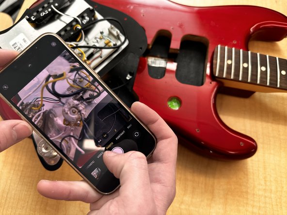

    • The volume potentiometer is the one closest to the middle of the pickguard.
    • Take multiple pictures of the potentiometer to ensure you have a reference showing how each component is wired.
    • Make sure to have least one picture of every connection.
    • Also note which way the legs of the potentiometer are pointed, as it is best to maintain the potentiometer's orientation when putting the guitar back together.

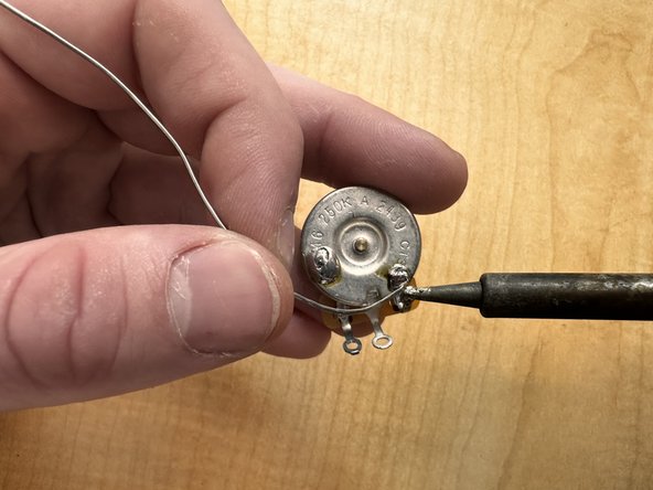

  8. Fender Stratocaster Volume Potentiometer Replacement: passo 8, immagine 1 di 3 Fender Stratocaster Volume Potentiometer Replacement: passo 8, immagine 2 di 3 Fender Stratocaster Volume Potentiometer Replacement: passo 8, immagine 3 di 3

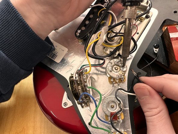

    • Plug in and heat up your soldering iron.
    • Once your soldering iron is hot, prepare to desolder the ground wires (the wires connected to the cylindrical base of the potentiometer).
    • Grab the wire, and gently pull it away from the potentiometer.
    • Melt the solder on the ground connections by touching the tip of the soldering iron to it. Continue pulling on the wire with your other hand.
    • Once the solder is melted enough, the wire will easily pull away.
    • Be careful to not touch any other wires with the soldering iron.
    • Be careful when holding the wires, as they'll become hot really fast.
    • Use desoldering wick to clean up the remaining solder.

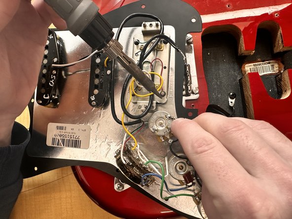

    • Repeat the previous step with the remaining ground wires.
  10. Fender Stratocaster Volume Potentiometer Replacement: passo 10, immagine 1 di 3 Fender Stratocaster Volume Potentiometer Replacement: passo 10, immagine 2 di 3 Fender Stratocaster Volume Potentiometer Replacement: passo 10, immagine 3 di 3

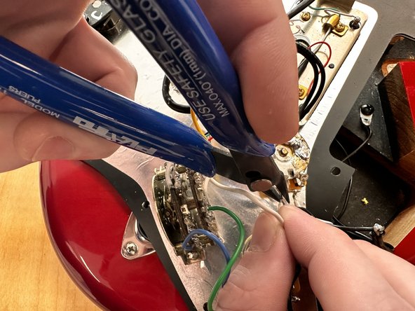

    • The two wires connected to the legs of the potentiometer are hooked into the holes of the legs, so it is safer to cut them than desolder them.
    • Take your wire cutters and cut as little of the wire off as possible. If the metal of the wire is no longer visible after cutting, slightly roll up the wire insulation.
    • Repeat these steps for the last remaining wire.

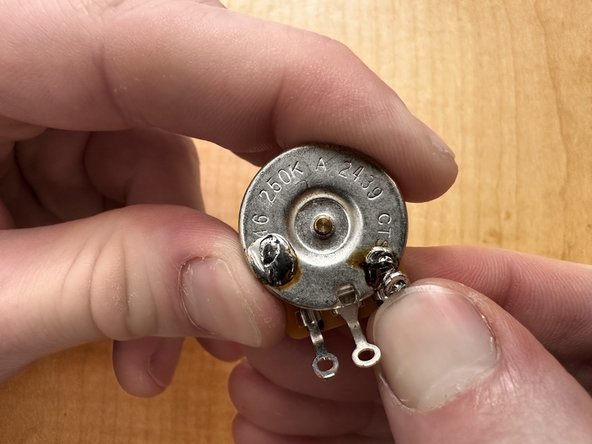

    • Holding the potentiometer upside down, bend the rightmost leg to touch the body of the pot.
    • Solder the leg to the body.
    • This can be achieved by melting a bit of solder to the body before bending the leg, and then heating it up once the leg is already touching it.
