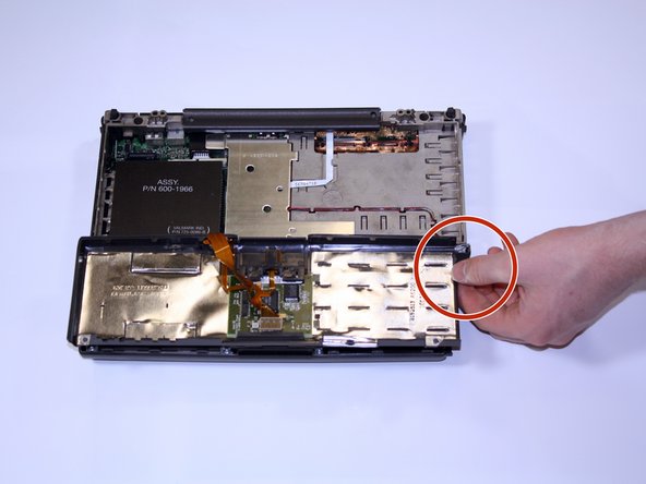

  4. Apple Powerbook 5300 Trackpad Replacement, Trackpad: passo 4, immagine 1 di 2 Apple Powerbook 5300 Trackpad Replacement, Trackpad: passo 4, immagine 2 di 2
    • To begin the replacement process, refer to the prerequisite guides listed in the details portion of the guide.
    • To begin, carefully grip the bottom portion of the computer as pictured.
    • Next, lift up on the front portion of the laptop.
    • Watch out for the ribbon cable. Damage to this cable may result in harm of computer peformance.
    • Carefully disconnect it by grasping the cable, pulling straight up and out of its connector.

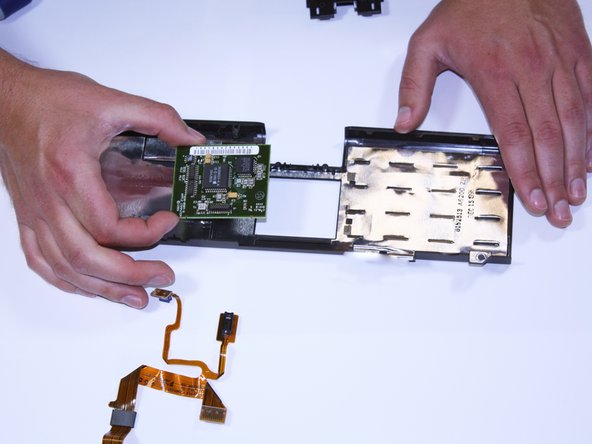

  6. Apple Powerbook 5300 Trackpad Replacement: passo 6, immagine 1 di 2 Apple Powerbook 5300 Trackpad Replacement: passo 6, immagine 2 di 2
    • Unscrew the last torx #8 screw holding the trackpad assembly in place.
    • Now the entire trackpad will lift out of place.
    • Disconnect all ribbon cables from their connectors.
    • Note: refer to the first picture for a reference for reassembly.
