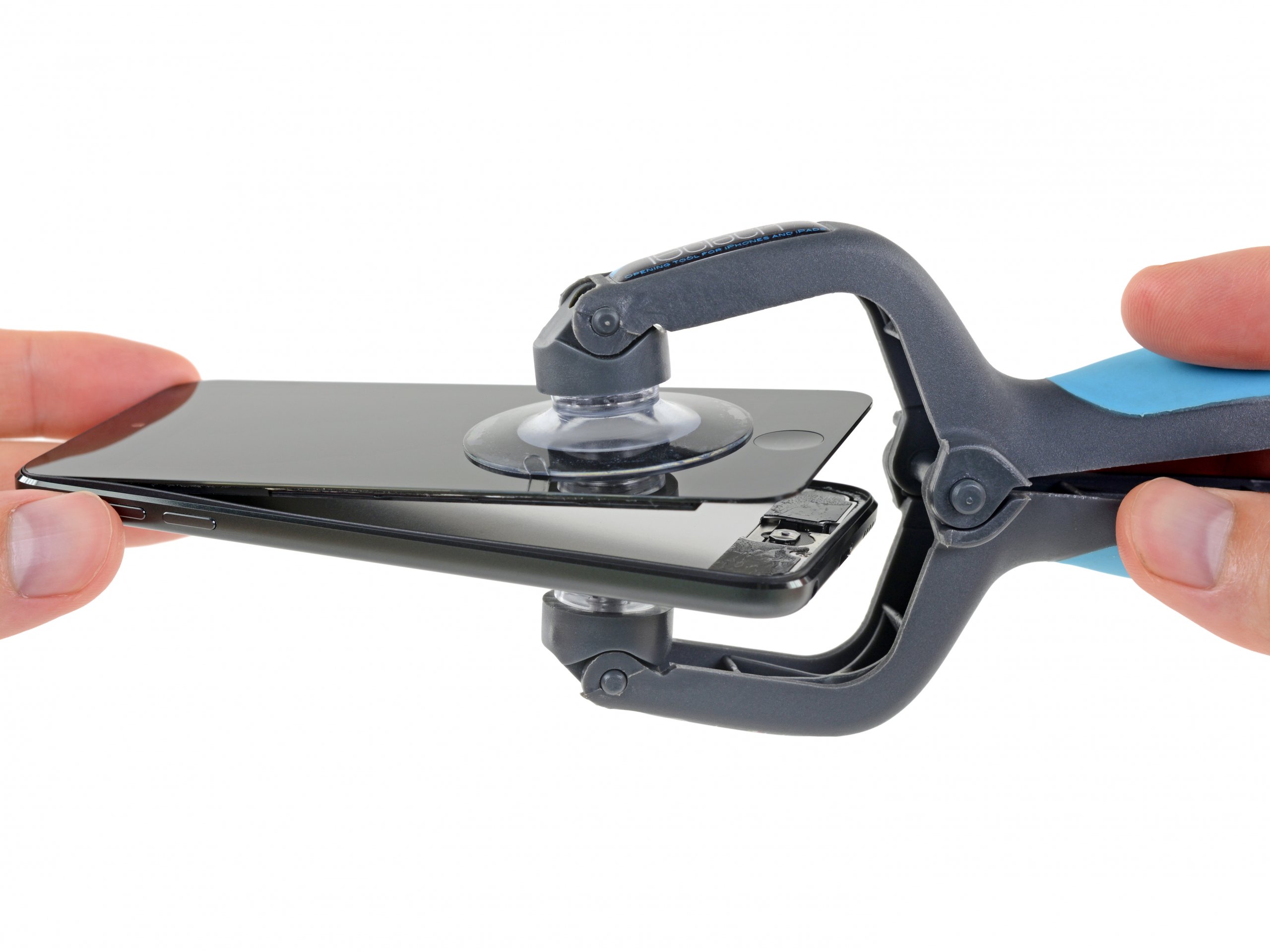

On the surface, the only change we spotted from the last (sixth generation) iPod Touch was a new model number—A2178. We cracked it open with the same heat-and-suction method as before, which is just a wee bit disappointing. Given that the Touch looks a lot like an iPhone, we hoped for a more iPhone-esque opening procedure, maybe involving some screws. Alas, this is a fussy combination of clips and glue.
