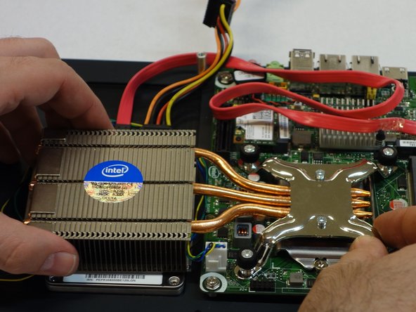

  3. why! WDi7SSD Replace processor (CPU), Processor (CPU): passo 3, immagine 1 di 3 why! WDi7SSD Replace processor (CPU), Processor (CPU): passo 3, immagine 2 di 3 why! WDi7SSD Replace processor (CPU), Processor (CPU): passo 3, immagine 3 di 3
    • Loosen the 4 PH2 Phillips screws of the heat sink.
    • Now remove the heat sink.

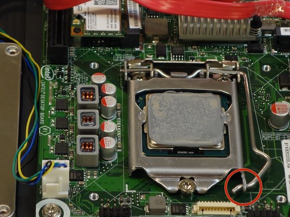

  4. why! WDi7SSD Replace processor (CPU): passo 4, immagine 1 di 2 why! WDi7SSD Replace processor (CPU): passo 4, immagine 2 di 2
    • Use the screwdriver to unscrew the three PH2 slotted screws to release the CPU holder.
    • Press down the spring on the right side of the CPU and pull it carefully to the side.
    • Put the CPU aside.
    • To remove the thermal paste, you can use isopropanol. The thermal paste must be completely removed from the heatsink and CPU.
