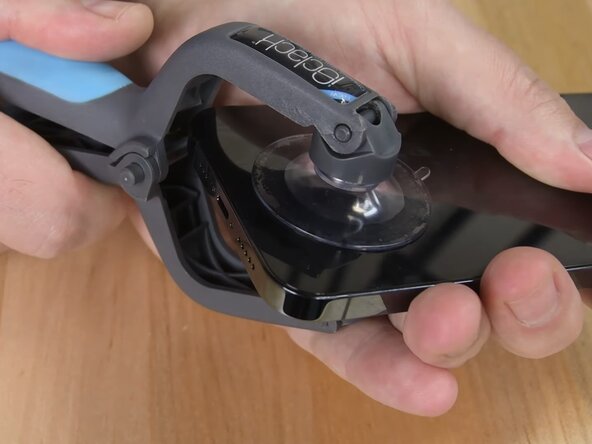

  2. iPhone 12 Pro Max Screen Replacement, Lifting The Screen: passo 3, immagine 1 di 1
    • After heating the device, position the suction cup just above the charging port area. Firmly press down to create suction, then gently lift until a small gap appears. Once an opening is visible, carefully insert a pick to begin separating the screen.
