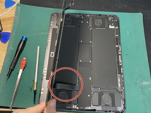

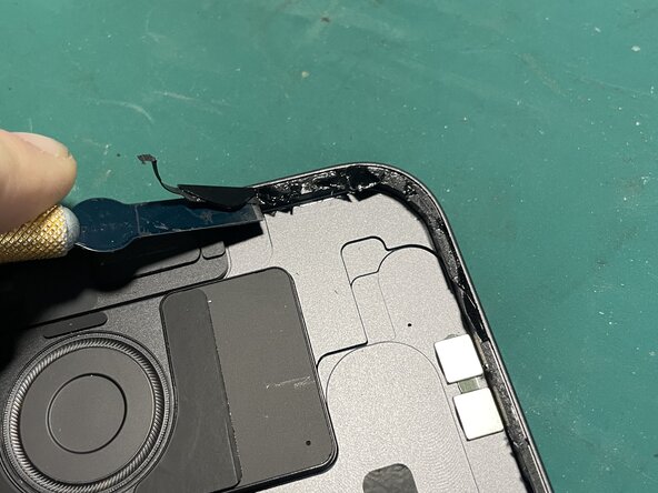

  3. iPad Pro M4 13" Screen Replacement, Separate Glass From Frame: passo 3, immagine 1 di 3 iPad Pro M4 13" Screen Replacement, Separate Glass From Frame: passo 3, immagine 2 di 3 iPad Pro M4 13" Screen Replacement, Separate Glass From Frame: passo 3, immagine 3 di 3
    • * Start by inserting your X-ACTO knife in between the glass and the metal frame in the TOP LEFT. (Do not to go too far, the picture I provided shows how far you should be putting your tools)
    • *Notice that I applied alcohol to the pic and glass. (Using alcohol is safe as long as you don't drowned the device.) - The adhesive on this iPad is really weak when alcohol is added.
    • As you slide your pick down the glass you may encounter cracks. You will want to slightly lift the glass with your pic and slide the X-ACTO under where the crack is and then continue sliding pic down (Shown in Picture 2)
    • Picture 3 shows examples of cables you want to be cautious around. **Look at the back of your new part and get accustomed to it.**

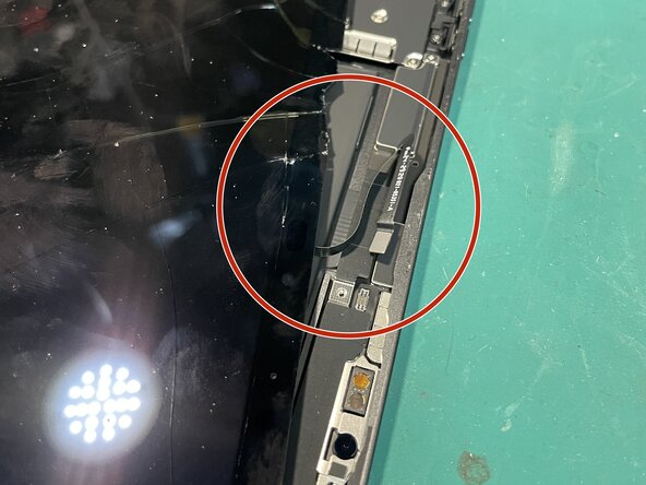

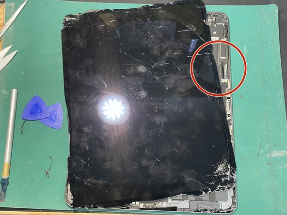

  4. iPad Pro M4 13" Screen Replacement, Unplug Front Mic: passo 4, immagine 1 di 3 iPad Pro M4 13" Screen Replacement, Unplug Front Mic: passo 4, immagine 2 di 3 iPad Pro M4 13" Screen Replacement, Unplug Front Mic: passo 4, immagine 3 di 3
    • Before you fully lift the screen, position the ipad as shown in the picture with charging port pointing toward you because you will need to unplug a cable
    • Once you unplug this cable, you can safely lift the screen up to the left like a book as shown in the 4th photo. (Be mindful of the cables not to damage them or the board by causing to much upward strain)

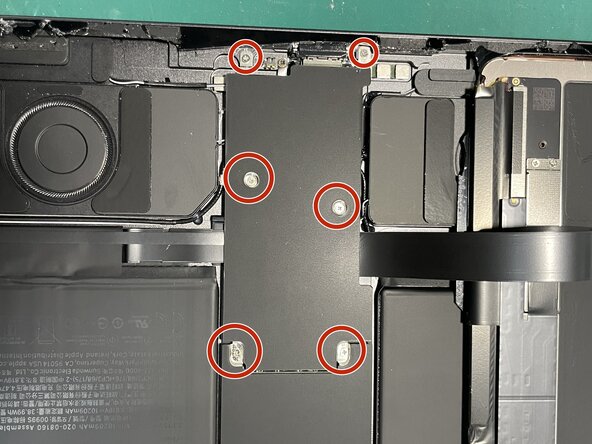

  5. iPad Pro M4 13" Screen Replacement, Remove LCD Plate & Clean Frame: passo 5, immagine 1 di 3 iPad Pro M4 13" Screen Replacement, Remove LCD Plate & Clean Frame: passo 5, immagine 2 di 3 iPad Pro M4 13" Screen Replacement, Remove LCD Plate & Clean Frame: passo 5, immagine 3 di 3
    • First you will remove all the screws for the plate covering the battery and screen connectors.
    • ***ALWAYS UNPLUG BATTERY FIRST AND PLUG BACK IN LAST.** You want the battery to be unplugged first. During reassembly you will want to plug the battery in last.

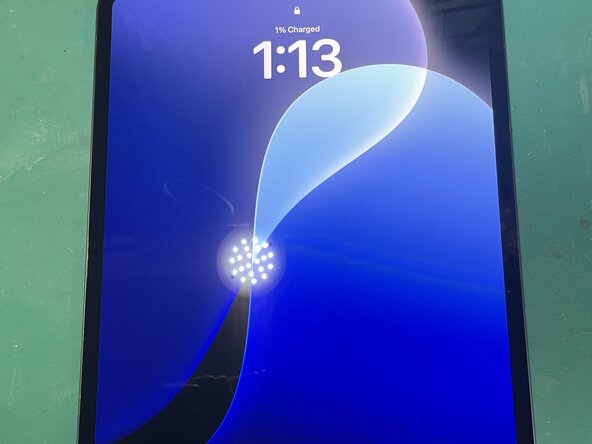

    • Now you will plug in your NEW SCREEN (With small parts) to the iPad.
    • Then plug in the Battery.
    • After you have tested your screen to make sure it is not defective, you can screw the plate that covers the OLED Connectors back down.
    • **Remember that when you are laying the screen back down you need to lay it down slightly crooked at first to plug in the front mic.
    • After you have plugged the front mic back in and screwed the plate back down, you can now remove the plastic from your adhesive and fully close the iPad.
