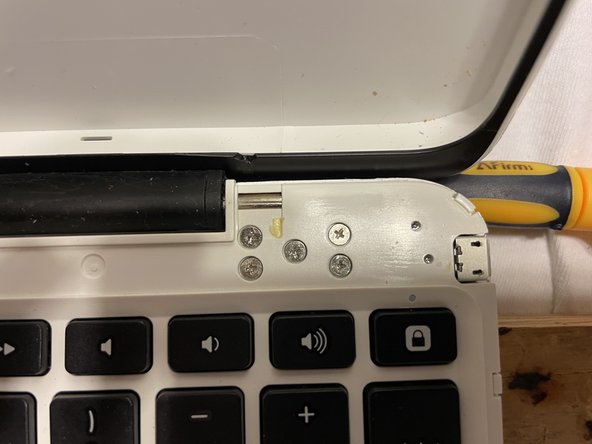

    • Once the silver overlay is removed, it exposes all the securing screws: 5 screws on each left and right hinge and 9 screws along the base area below the keys.
    • Slowly and gently remove all the screws. Once they are out, the bottom plastic shell will pop out. This is where the first step loosening the plastic shell helps. Slowly pop the clips free around the edges to reveal the bottom of the keypad and battery.
