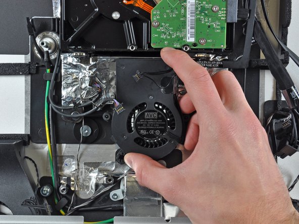

  35. iMac Intel 21.5" EMC 2308 Hard Drive Fan Replacement, Hard Drive Fan: passo 35, immagine 1 di 2 iMac Intel 21.5" EMC 2308 Hard Drive Fan Replacement, Hard Drive Fan: passo 35, immagine 2 di 2
    • Remove the single 13mm T10 Torx screw securing the hard drive fan to the outer case.
    • Remove the hard drive fan from the outer case.
