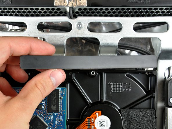

  30. iMac Intel 20" EMC 2266 Hard Drive Data Cable Replacement, Hard Drive Data Cable: passo 30, immagine 1 di 3 iMac Intel 20" EMC 2266 Hard Drive Data Cable Replacement, Hard Drive Data Cable: passo 30, immagine 2 di 3 iMac Intel 20" EMC 2266 Hard Drive Data Cable Replacement, Hard Drive Data Cable: passo 30, immagine 3 di 3
    • To remove the hard drive bracket, squeeze the middle against the size of the hard drive while rotating the top left edge toward yourself.
    • After the left edge has been freed, rotate the bracket toward the right edge of the hard drive.
    • Lift the hard drive bracket straight up off the chassis.

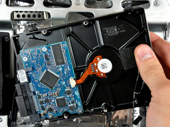

  31. iMac Intel 20" EMC 2266 Hard Drive Data Cable Replacement: passo 31, immagine 1 di 2 iMac Intel 20" EMC 2266 Hard Drive Data Cable Replacement: passo 31, immagine 2 di 2
    • Rotate the top of the drive toward yourself, then lift the hard drive straight up off its lower pins.
    • When reinstalling your hard drive, be careful not to push the rubber grommets through the openings in the chassis with the lower hard drive pins as retrieving them may require logic board removal.
