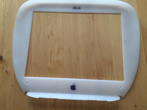

Replacing the bezel covering the Lcd

  1. iBook G3 Clamshell LCD Bezel Replacement, Battery Cover: passo 1, immagine 1 di 1
    • Use a coin to unscrew the battery cover, and remove battery.
  2. iBook G3 Clamshell LCD Bezel Replacement, Back Cover: passo 2, immagine 1 di 2 iBook G3 Clamshell LCD Bezel Replacement, Back Cover: passo 2, immagine 2 di 2
    • Use a t8 Torx driver to unscrew the two screws holding in the back cover, then remove the cover.
  3. iBook G3 Clamshell LCD Bezel Replacement: passo 3, immagine 1 di 1
    • Open the screen, and remove the two t8 Torx screws holding the bezel in place.
  4. iBook G3 Clamshell LCD Bezel Replacement: passo 4, immagine 1 di 2 iBook G3 Clamshell LCD Bezel Replacement: passo 4, immagine 2 di 2
    • Use a flat tip screw driver to unsnap the bezel from its place.
    • When at the top rubberized area, pry the bezel down.
