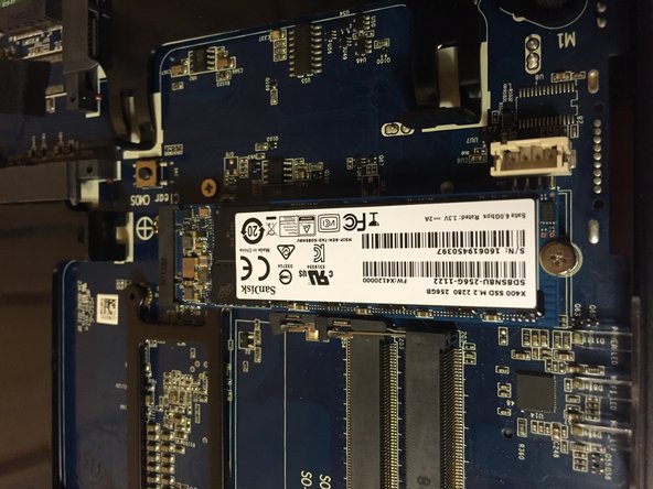

  3. Zotac EN970 Storage Replacement, M.2 Drive: passo 3, immagine 1 di 2 Zotac EN970 Storage Replacement, M.2 Drive: passo 3, immagine 2 di 2
    • The M.2 drive requires a phillips screwdriver for installation. Your ZBOX should have two screws inserted in two of the three pegs.
    • Remove the screws, insert your drive and use one screw to secure it. Be sure not to over-tighten.
