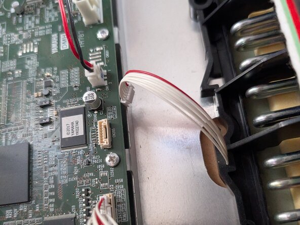

    • Remove these three screws at the top of the back side.
    • Push the top cover to the front side. It is locked on the inside with a slide mechanism.
    • There is a cable connected to the top cover. Lift the cover carefully and disconnect the cable.

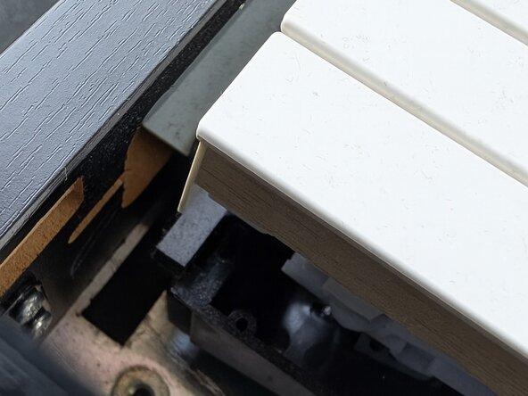

  2. Yamaha CLP-645 - Cleaning Note Key Contacts, Remove Key Cover: passo 2, immagine 1 di 2 Yamaha CLP-645 - Cleaning Note Key Contacts, Remove Key Cover: passo 2, immagine 2 di 2

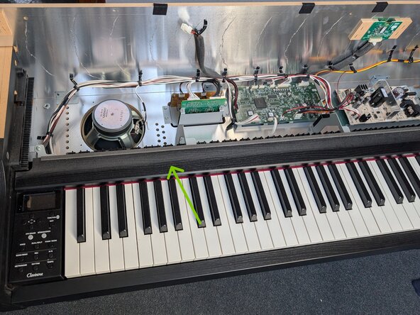

    • Remove this clip on the covers rails.
    • Use the new opening on the cover rails to remove the back pins of the key cover. The pins at the front of the cover cannot be moved up to this point. Instead, tilt the cover slightly to remove them from the guide rails at the front (after removing the back side pins).

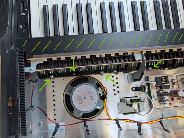

    • The decorative key cover at the top of the keys needs to be removed.
    • Remove the screws at the metal connectors.
    • The two screws at the left and right side are slightly different (metal screws); The six screws in the wood are the same.

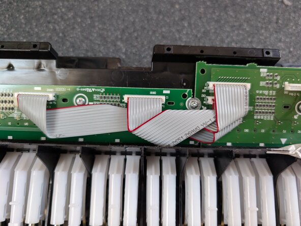

    • Remove the computer parts on the left and right of the key board. They are secured with one screw only.

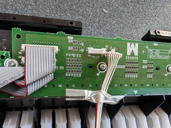

    • Disconnect the cable between the keyboard assembly and the main PCB.
    • Remove the large screws and two small screws on the back side of the keyboard.
    • The keyboard is secured in a guide rail at the front. Push the entire keyboard assembly slightly to the back and take it out the top.

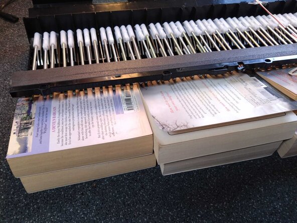

  6. Yamaha CLP-645 - Cleaning Note Key Contacts, Prepare Keyboard Assembly: passo 6, immagine 1 di 3 Yamaha CLP-645 - Cleaning Note Key Contacts, Prepare Keyboard Assembly: passo 6, immagine 2 di 3 Yamaha CLP-645 - Cleaning Note Key Contacts, Prepare Keyboard Assembly: passo 6, immagine 3 di 3

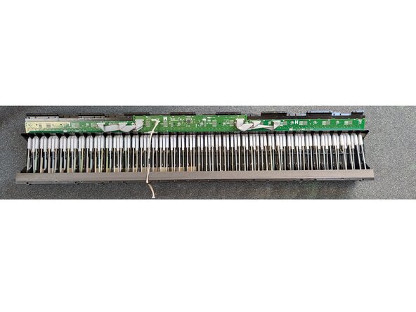

    • Lay the keyboard assembly on its back. Now, all keys are pressed, which makes it more difficult to remove the PCBs with the silicone mats.
    • Disconnect the cable from the middle PCB.
    • Push up the metal levers to relax the keys and the silicone mats. You can use books or broom stick or similar.
