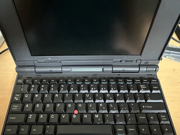

  5. WinBook XP5 Motherboard Replacement, Keyboard: passo 5, immagine 1 di 3 WinBook XP5 Motherboard Replacement, Keyboard: passo 5, immagine 2 di 3 WinBook XP5 Motherboard Replacement, Keyboard: passo 5, immagine 3 di 3
    • Flip the laptop over and (carefully!) open the hinges, if the lid was shut before.
    • To remove the keyboard, slide the retention bar above the keyboard to the right, then pull it out. Once removed, the keyboard can be lifted up and sat against the display.
    • The keyboard has three cables coming out of it, which plug into ZIF connectors on the motherboard. Once disconnected, the keyboard can be lifted fully out of the laptop.

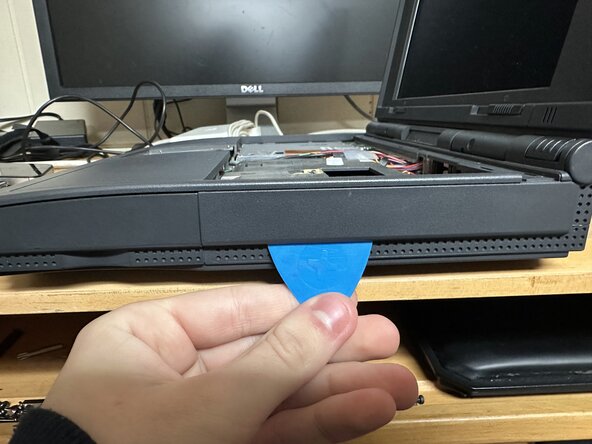

  8. WinBook XP5 Motherboard Replacement, Display and Palmrest Assembly: passo 8, immagine 1 di 3 WinBook XP5 Motherboard Replacement, Display and Palmrest Assembly: passo 8, immagine 2 di 3 WinBook XP5 Motherboard Replacement, Display and Palmrest Assembly: passo 8, immagine 3 di 3
    • Insert a plastic clip between the palmrest and lower case at the front, as shown in the photo. Slide the pick to the right to release all the clips at the front of the laptop. Then, pop one more clip on the right side. After this, you should be able to very carefully begin lifting the upper half off the laptop.
    • You now have to maneuver the two halves free. The upper half will catch on the floppy drive eject button, and then also on the modem, as it was originally intended to be slid out of the laptop first. With care, you should be able to clear both parts.
    • As you're lifting it free, you will have to disconnect two additional cables, which were previously hidden under the left palmrest. These are the connectors for the speakers and microphone.
    • After disconnecting those last two connectors, the two halves should be separated.

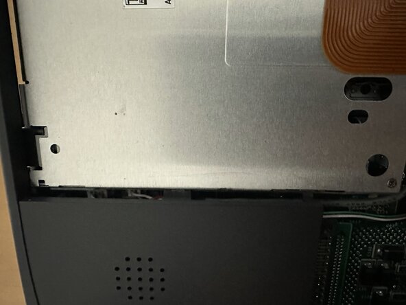

  9. WinBook XP5 Motherboard Replacement, Floppy Drive, Modem, Hard Drive: passo 9, immagine 1 di 1
    • Remove the modem by sliding it free from its connector
    • Remove the floppy drive by removing the screw highlighted in the photo, disconnecting its ribbon cable, and then lifting the drive out of the computer.
    • Remove the hard drive by sliding it free from its connector.
