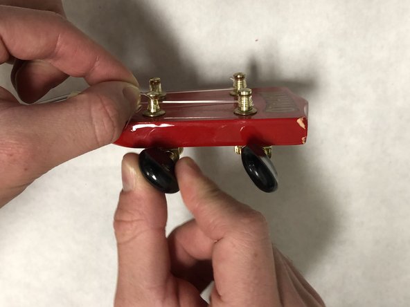

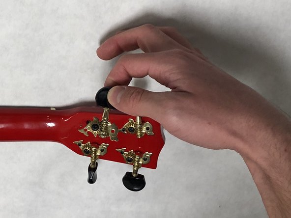

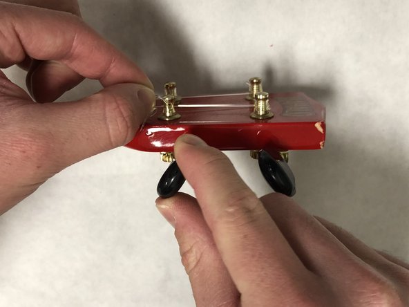

  1. Ukulele Tuning Pegs Replacement, Tuning Pegs: passo 1, immagine 1 di 3 Ukulele Tuning Pegs Replacement, Tuning Pegs: passo 1, immagine 2 di 3 Ukulele Tuning Pegs Replacement, Tuning Pegs: passo 1, immagine 3 di 3
    • Place the ukulele on a flat surface.
    • Completely unwind the string connected to the broken tuning peg by turning the black knob clockwise.
