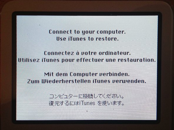

Ora collega l'adattatore ZIF a CF al cavo piatto ZIF dell'iPod. Puoi usare anche un adattatore SD - CF, ma non tutti funzionano correttamente.
Dopo il riassemblaggio devi fare il restore dell'iPod da iTunes.

Used a 64gb Sandisk Micro SD (in a regular SD adapter), and it restored through iTunes no problem
I’m used the same 64gb card,but it did not work.The ipod still in the Apple logo.Could you give me some ideals,thank you.
1. I had an 80gb 5th gen ipod classic. i upgraded my ipod to a 128gb SD which worked without issue (i’m not sure what the limitations are but my ipod came up saying it was a 128gb ipod).
