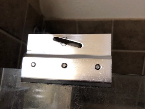

    • Locate the top metal cover.
    • Unlatch the wheels by pushing the door away and up from you to bring the wheels out of the track.
    • Once the wheels have been unlatched from the track, push the metal cover all the way up and set aside.

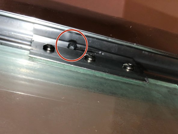

    • Identify why the wheels are not working properly.
    • You will want to check for rust, or any kind of blockage. Especially on the wheel bearing (metal screw 7mm) that holds the wheel in place.
