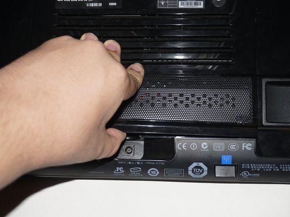

  2. Shortcut method - HP Touchsmart IQ506 CMOS Battery, Unplug the power cord: passo 2, immagine 1 di 2 Shortcut method - HP Touchsmart IQ506 CMOS Battery, Unplug the power cord: passo 2, immagine 2 di 2
    • Shut the computer down and unplug the power adapter.

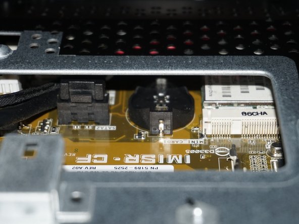

  7. Shortcut method - HP Touchsmart IQ506 CMOS Battery, Removing the battery: Part 1: passo 7, immagine 1 di 2 Shortcut method - HP Touchsmart IQ506 CMOS Battery, Removing the battery: Part 1: passo 7, immagine 2 di 2
    Attrezzo utilizzato in questo passaggio:
    • This is when the method used in this guide starts to get advanced. DO NOT CONTINUE unless you know how to disassemble the system should the battery fall in the system! IMPORTANT: Make sure you use blunt-ended tweezers.
    • Unclip the top of the battery using your fingernails. You do not need to use tweezers yet.
  8. Shortcut method - HP Touchsmart IQ506 CMOS Battery, Removing the battery: Part 2: passo 8, immagine 1 di 2 Shortcut method - HP Touchsmart IQ506 CMOS Battery, Removing the battery: Part 2: passo 8, immagine 2 di 2
    • With the battery unclipped, use the tweezers to grab the battery. Pull the battery out while keeping a firm grip to avoid dropping it.
