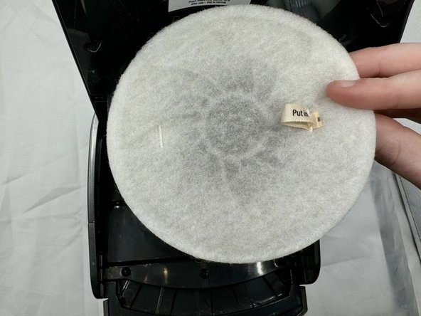

    3. Shark Apex DuoClean Powered Lift Away AZ1002 Foam and Felt Filters Replacement: passo 3, immagine 1 di 3 Shark Apex DuoClean Powered Lift Away AZ1002 Foam and Felt Filters Replacement: passo 3, immagine 2 di 3 Shark Apex DuoClean Powered Lift Away AZ1002 Foam and Felt Filters Replacement: passo 3, immagine 3 di 3
      • Pull the filter tab up to remove the large white foam filter and circular thin form at the bottom.

    4. Shark Apex DuoClean Powered Lift Away AZ1002 Foam and Felt Filters Replacement: passo 4, immagine 1 di 2 Shark Apex DuoClean Powered Lift Away AZ1002 Foam and Felt Filters Replacement: passo 4, immagine 2 di 2
      • Remove the white foam filter.
      • Go to a trash bin and shake both filters to remove loose dirt carefully debris.
