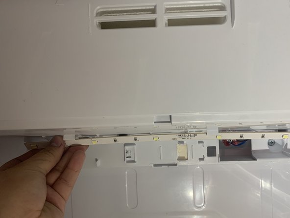

    • Disconnect the refrigerator for the electrical outlet box.
    • Remove the cover that protects the LED light.

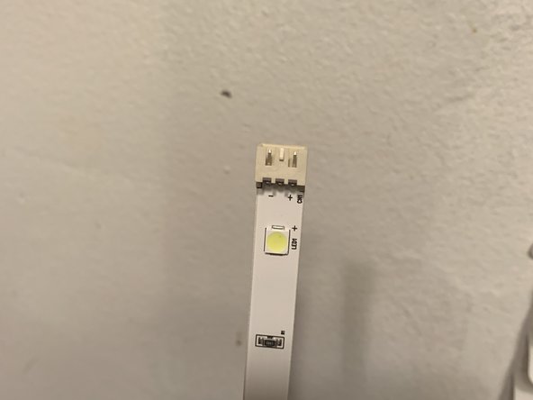

    • Disconnect the damaged light from the connection.
  3. Samsung RS25J500DSR LED Light Replacement: passo 3, immagine 1 di 3 Samsung RS25J500DSR LED Light Replacement: passo 3, immagine 2 di 3 Samsung RS25J500DSR LED Light Replacement: passo 3, immagine 3 di 3
    • Remove the damaged LED light to insert the new one on the connection.
    • Be careful not to damage the clip from the connection when removing the LED light.

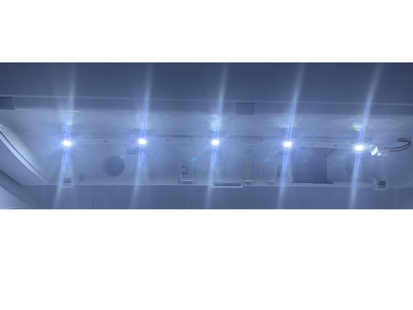

    • To connect the new LED light, clip it onto the connector.
    • After connecting the new LED strip reconnect the refrigerator to see if the light is working.
