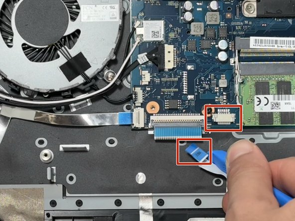

  7. Samsung Notebook 5 NP530E5M Touchpad Button Board Replacement, Touchpad Button Board: passo 7, immagine 1 di 2 Samsung Notebook 5 NP530E5M Touchpad Button Board Replacement, Touchpad Button Board: passo 7, immagine 2 di 2
    • Using a spudger or iFixit opening tool, remove the clip holding the ribbon cable in place on the motherboard.
    • The small plastic clip is important for the re-installation process, so be sure to place it in a secure location.
  8. Samsung Notebook 5 NP530E5M Touchpad Button Board Replacement: passo 8, immagine 1 di 3 Samsung Notebook 5 NP530E5M Touchpad Button Board Replacement: passo 8, immagine 2 di 3 Samsung Notebook 5 NP530E5M Touchpad Button Board Replacement: passo 8, immagine 3 di 3
    • Using a spudger or iFixit opening tool, carefully peel back the two layers of security tape covering the second cable mount.
    • You may fold back the tape and let it rest gently, to be able to re-seal it after replacement.

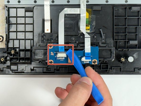

  9. Samsung Notebook 5 NP530E5M Touchpad Button Board Replacement: passo 9, immagine 1 di 3 Samsung Notebook 5 NP530E5M Touchpad Button Board Replacement: passo 9, immagine 2 di 3 Samsung Notebook 5 NP530E5M Touchpad Button Board Replacement: passo 9, immagine 3 di 3
    • Using your Phillips #000 screwdriver, remove the three 3 mm screws holding the board in place.
    • Locate and peel up the yellow tape from the third (back) ribbon cable.
    • Using the spudger, pry the black plastic clip that secures the ribbon cable and remove the ribbon cable.

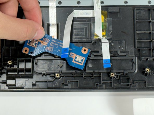

  10. Samsung Notebook 5 NP530E5M Touchpad Button Board Replacement: passo 10, immagine 1 di 3 Samsung Notebook 5 NP530E5M Touchpad Button Board Replacement: passo 10, immagine 2 di 3 Samsung Notebook 5 NP530E5M Touchpad Button Board Replacement: passo 10, immagine 3 di 3
    • You may now use a spudger or iFixit opening tool to gently lift the board from its seat.
    • Remove the faulty board and dispose of it responsibly.
    • Now following the steps in reverse, you will be able to install the new touchpad button board.
