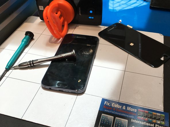

  1. Samsung Galaxy S7 Display Replacement, Loosen the adhesive: passo 1, immagine 1 di 1
    • Heat the back of the phone to melt the adhesive holding the back plate on. I use an electronic heating pad, set to 60° Celsius. You can also use a heat gun, but I do not like using them. Be extra careful if using a heat gun, as they are easier to burn yourself with, and holding one over a phone for even just a little too long can damage it.
  2. Samsung Galaxy S7 Display Replacement, Remove the back plate: passo 2, immagine 1 di 3 Samsung Galaxy S7 Display Replacement, Remove the back plate: passo 2, immagine 2 di 3 Samsung Galaxy S7 Display Replacement, Remove the back plate: passo 2, immagine 3 di 3
    • Use a suction cup on the bottom half of the back plate to begin to lift the bottom edge of the plate up, being careful not to apply to much pressure.
    • Once you have enough of the back plate lifted to fit a guitar pick, insert one underneath. Slide the guitar pick around the entire edge of the phone to break the adhesive.
    • Remove the back plate.
