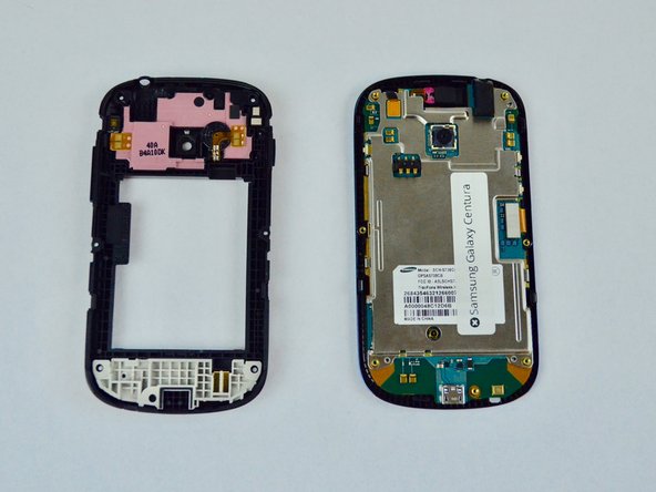

  4. Samsung Galaxy Centura Lock and Volume Buttons Replacement: passo 4, immagine 1 di 2 Samsung Galaxy Centura Lock and Volume Buttons Replacement: passo 4, immagine 2 di 2
    • Locate the indentation on the side of the device, and gently insert the plastic opening tool into it. With a firm prying motion, the plastic should begin to come apart.

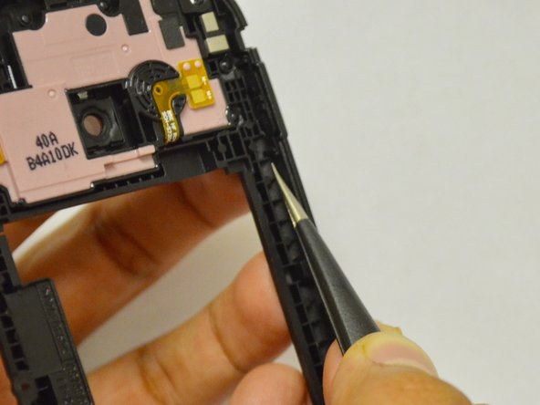

  5. Samsung Galaxy Centura Lock and Volume Buttons Replacement: passo 5, immagine 1 di 1
    Attrezzo utilizzato in questo passaggio:
    • Locate the volume buttons on the plastic casing.
    • Gently pull the black tab up and out with the tweezers, then push or pull the button inward and out of the plastic casing. It should come free without resistance.
