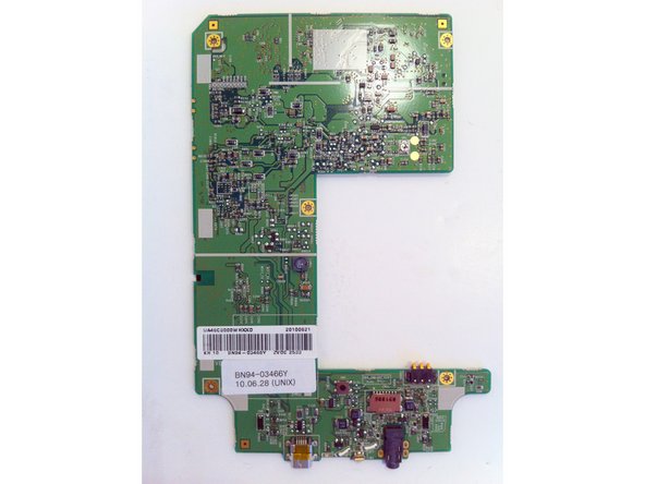

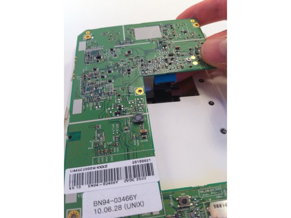

  4. Samsung E60 eReader Teardown, Main PCB: passo 4, immagine 1 di 3 Samsung E60 eReader Teardown, Main PCB: passo 4, immagine 2 di 3 Samsung E60 eReader Teardown, Main PCB: passo 4, immagine 3 di 3
    • The main PCB is maintained by 2 hooks at the top and 2 at the bottom
    • Make sure the keyboard is in the open position to get the maximum length for the screen's Flat Plastic Cable (FPC)
    • Press the 2 top hooks to release the PCB
    • There may be a sticker close to the 2 bottom hooks: peel it
    • Lift the PCB up and disconnect the screen FPC cable, then remove completely the PCB from the plastic case

  12. Samsung E60 eReader Teardown, PCB views: passo 12, immagine 1 di 2 Samsung E60 eReader Teardown, PCB views: passo 12, immagine 2 di 2
    • As a reference, here are the PCB top and bottom views.
