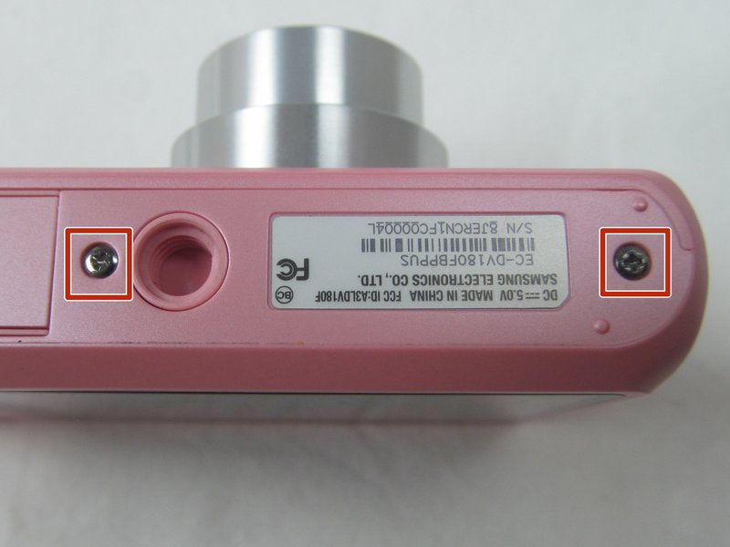

    1. Samsung DV180F Repair Back control buttons Replacement, Back Buttons Panel: passo 1, immagine 1 di 2 Samsung DV180F Repair Back control buttons Replacement, Back Buttons Panel: passo 1, immagine 2 di 2
      • Ensure the camera is turned off and battery is taken out before you begin.
      • Remove the two external screws from the camera using a Phillips 000 screwdriver.
