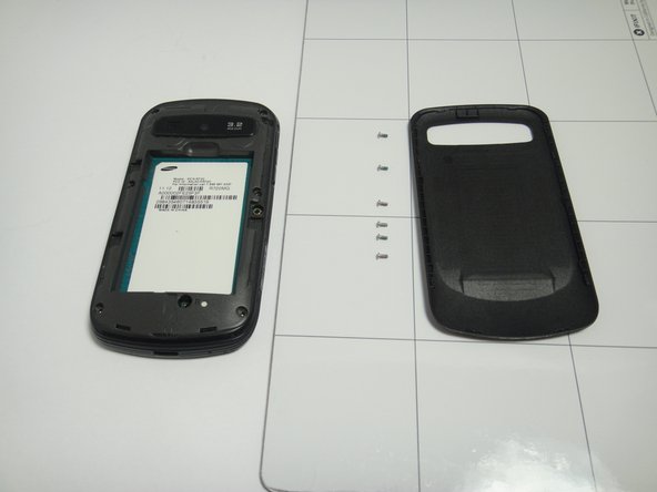

  3. Samsung Admire Speaker Replacement, Remove the screws: passo 3, immagine 1 di 3 Samsung Admire Speaker Replacement, Remove the screws: passo 3, immagine 2 di 3 Samsung Admire Speaker Replacement, Remove the screws: passo 3, immagine 3 di 3
    • Use the Phillips #00 Precision Screwdriver to remove the six screws in the back of the phone.

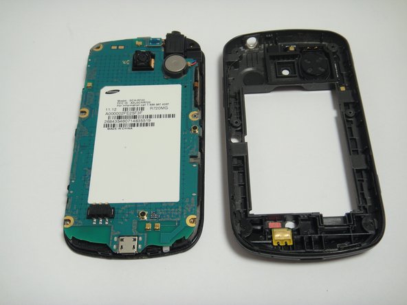

  4. Samsung Admire Speaker Replacement, Inside back cover: passo 4, immagine 1 di 3 Samsung Admire Speaker Replacement, Inside back cover: passo 4, immagine 2 di 3 Samsung Admire Speaker Replacement, Inside back cover: passo 4, immagine 3 di 3
    • Use the plastic opening tools to remove the inside back cover.
    • Place the plastic opening tools on the outside rim of the inside back cover.
    • Carefully lift the cover and circle around the rim to open the inside back cover completely.
    • Carefully disconnect ribbon cables and slowly lift the inside back cover to remove it.
  5. Samsung Admire Speaker Replacement, Speaker: passo 5, immagine 1 di 2 Samsung Admire Speaker Replacement, Speaker: passo 5, immagine 2 di 2
    • The speaker is located within the inside of the back cover.
    • Simply remove it by lifting it off with the plastic opening tool.
