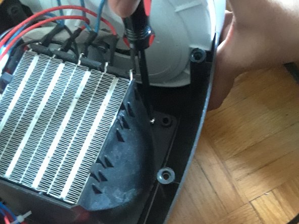

  1. Royal Sovereign Fan Replacement, Fan: passo 1, immagine 1 di 2 Royal Sovereign Fan Replacement, Fan: passo 1, immagine 2 di 2
    • Make sure that the heater is unplugged and completely cooled down.
    • Turn the heater so the back is facing up.
    • Remove all six 14 mm screws using the Philips #0 screwdriver.
  2. Royal Sovereign Fan Replacement: passo 2, immagine 1 di 1
    • Separate the back case from the heater.

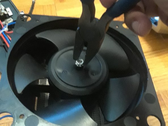

  4. Royal Sovereign Fan Replacement: passo 4, immagine 1 di 2 Royal Sovereign Fan Replacement: passo 4, immagine 2 di 2
    • Turn the motor over to reveal the fan.
    • Use a plier to twist and unscrew the hexagonal screw attached to the fan.
    • Do not untangle the wires
  5. Royal Sovereign Fan Replacement: passo 5, immagine 1 di 1
    • Take the fan out.
