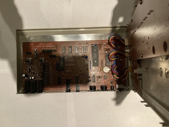

  4. Roland TR-505 LCD Display Replacement, Opening the Device: passo 4, immagine 1 di 2 Roland TR-505 LCD Display Replacement, Opening the Device: passo 4, immagine 2 di 2
    • Carefully separate the 2 half’s
    • If it’s not coming apart you may need a plastic pry tool to assist you
    • Once separated:with the ports facing you open the device like a book with the top panel lifted up slightly,make sure to open it to the right
  5. Roland TR-505 LCD Display Replacement, Unplugging the connectors: passo 5, immagine 1 di 1
    • Carefully unplug the connectors from their sockets by pulling on the tabs that stick out from the cable
    • Do not pull on the cable itself as you risk pulling the cables out of the connector
