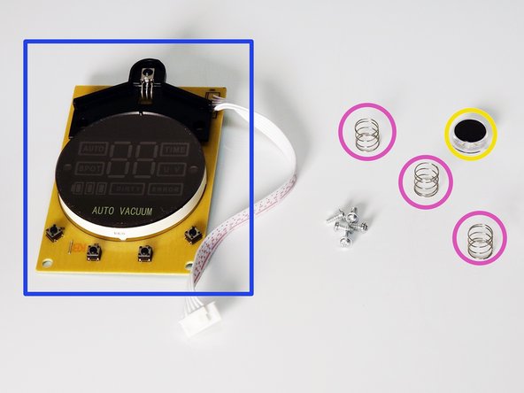

  5. Replacing bObsweep Standard's LCD Screen, bObsweep Standard's LCD Screen: passo 5, immagine 1 di 3 Replacing bObsweep Standard's LCD Screen, bObsweep Standard's LCD Screen: passo 5, immagine 2 di 3 Replacing bObsweep Standard's LCD Screen, bObsweep Standard's LCD Screen: passo 5, immagine 3 di 3
    • Bobsweep Standard has a circular screen that is held onto the cover by five screws. Remove these to lift all pieces of the screen out. They are
    • LCD screen
    • An infrared sensor on top of the screen which will easily pop out after removal
    • Three springs
    • Silver cover plate for bOb’s buttons.
  6. Replacing bObsweep Standard's LCD Screen: passo 6, immagine 1 di 3 Replacing bObsweep Standard's LCD Screen: passo 6, immagine 2 di 3 Replacing bObsweep Standard's LCD Screen: passo 6, immagine 3 di 3
    • Once you’ve removed all the pieces, you can replace them in the following order:
    • The Infrared sensor should go in with the black side on bOb’s outside.
    • The button cover goes into the space on the cover.
    • Then the three springs sit on top of the cover, on the spring holders between the plus signs.
  7. Replacing bObsweep Standard's LCD Screen: passo 7, immagine 1 di 2 Replacing bObsweep Standard's LCD Screen: passo 7, immagine 2 di 2
    • Finally the LCD display goes on top of the springs, facing down. Make sure to line up the holes in the screen with the screw posts on bOb’s cover.
    • Install all 5 screws to hold the screen and Infrared sensor in place.
    • To complete your repair, follow the Closing bObsweep's cover after repair
