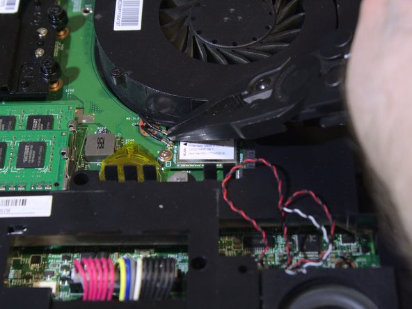

  4. Replace MSI GT72 2QE Dominator Pro Wireless Card: passo 4, immagine 1 di 2 Replace MSI GT72 2QE Dominator Pro Wireless Card: passo 4, immagine 2 di 2
    • Using a pair of pliers, remove both wires by pulling straight up from the wireless card.
    • Do not jerk or yank too hard as it can break off connectors.
