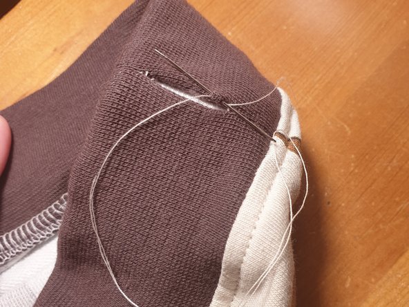

  1. Repair an open seam (ladder stitch / invisible stitch), Secure the thread start: passo 1, immagine 1 di 3 Repair an open seam (ladder stitch / invisible stitch), Secure the thread start: passo 1, immagine 2 di 3 Repair an open seam (ladder stitch / invisible stitch), Secure the thread start: passo 1, immagine 3 di 3
    • Cut a piece of sewing thread and thread the needle. It's better to take a bit too much thread than too little.
    • Insert the needle at the edge on one side of the opening, stitching in and out along the edge. The stitch should be 1-2 mm long.
    • Leave at least 5 cm of thread hanging.
    • Stitch again at the same entry point and come out at the same exit point.
    • Repeat this a second time, so you’ve sewn the same stitch a total of three times. This secures the thread so it won’t slip out.
    • I prefer using this technique to secure the starting thread instead of a knot. A knot can easily slip through the fabric. Plus, with this seam, it would be visible.
    • I should have actually started a bit further to the right here, where the intact seam still is. In my case, it’s not a big deal, but you’ll get a cleaner seam if you secure the thread where the intact seam is.
