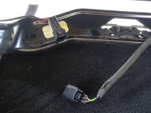

  2. Removing Ford Transit Connect Second Generation Back seat: passo 2, immagine 1 di 2 Removing Ford Transit Connect Second Generation Back seat: passo 2, immagine 2 di 2
    • Unplug the terminal block underneath the seat connecting wires by pressing very hard.

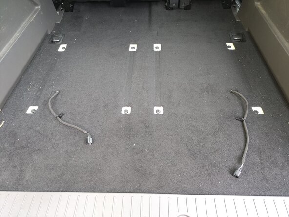

  4. Removing Ford Transit Connect Second Generation Back seat: passo 4, immagine 1 di 1
    • Screw back the screws in the holes and enjoy the space
