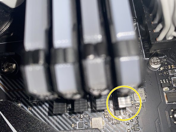

    • Remove current RAM
    • Push down on the clips holding down the current RAM
    • Carefully pull the RAM sticks out

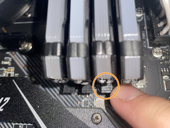

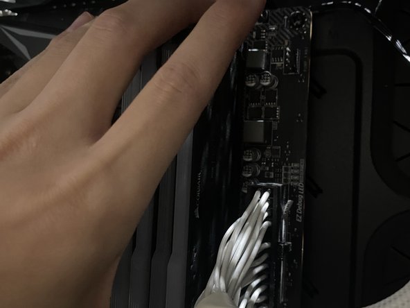

    • Install new RAM
    • Carefully put the new RAM sticks facing the right direction and in the correct slots.
    • Carefully apply pressure downwards on the RAM stick until the clip locks itself.
    • Make sure the clip is closed.

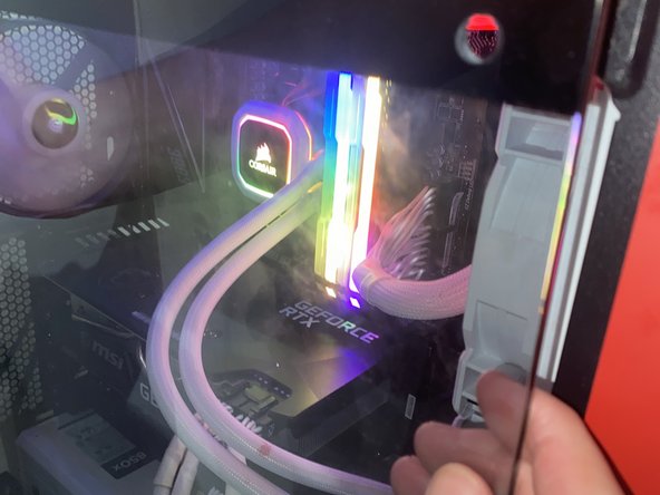

    • Put the window back onto the PC case
    • Screw the window onto the PC case

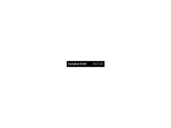

    • Check your system settings to make sure the RAM is installed properly
