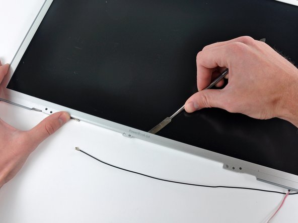

  18. PowerBook G4 Aluminum 17" 1-1.67 GHz Front Display Bezel Replacement: passo 21, immagine 1 di 3 PowerBook G4 Aluminum 17" 1-1.67 GHz Front Display Bezel Replacement: passo 21, immagine 2 di 3 PowerBook G4 Aluminum 17" 1-1.67 GHz Front Display Bezel Replacement: passo 21, immagine 3 di 3
    • Insert the flat end of a spudger between the front display bezel and the plastic rim attached to the rear bezel near the lower right corner of the display.
    • Do not try to insert the spudger between the front display bezel and its plastic surround.
    • While carefully prying the rear display bezel away from the display assembly, use a small flathead screwdriver to pry the small steel clip nearest the bottom right corner of the display away from the edge of the front display bezel.
    • Repeat the above procedure until you've released all the clips along the right side of the display.

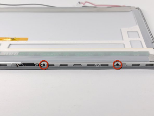

    • Remove the two 10.3 mm T8 Torx screws securing the left side of the clutch hinges to the front bezel.
  25. PowerBook G4 Aluminum 17" 1-1.67 GHz Front Display Bezel Replacement: passo 28, immagine 1 di 1
    • Remove the two 10.3 mm T8 Torx screws securing the center of the clutch hinges to the front bezel.
  26. PowerBook G4 Aluminum 17" 1-1.67 GHz Front Display Bezel Replacement: passo 29, immagine 1 di 1
    • Remove the two 10.3 mm T8 Torx screws securing the right side of the clutch hinges to the front bezel.

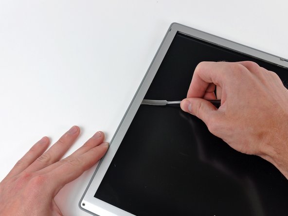

    • In the following steps, you will use a heat gun to soften the adhesive securing the metal LCD frame to the front display bezel. Heat guns have the capability of producing an extremely hot jet of air, so be sure not to overheat the LCD panel.
    • With the heat gun set to low, start by heating the front display bezel near the upper left corner of the display panel.
  43. PowerBook G4 Aluminum 17" 1-1.67 GHz Front Display Bezel Replacement: passo 46, immagine 1 di 2 PowerBook G4 Aluminum 17" 1-1.67 GHz Front Display Bezel Replacement: passo 46, immagine 2 di 2
    • Insert a plastic opening tool between the metal LCD frame and the front bezel.
    • Be sure you are prying between the metal LCD frame and the front bezel, not between the metal LCD frame and the LCD.
    • It may be necessary to reheat this area until the adhesive yields enough to insert the edge of a tool.
    • Use the flat end of a metal spudger to gently pry up the adhesive securing the metal LCD frame to the front bezel, taking special care not to scratch the LCD panel in the process.
  44. PowerBook G4 Aluminum 17" 1-1.67 GHz Front Display Bezel Replacement: passo 47, immagine 1 di 1
    • While it is still inserted between the metal LCD frame and the front bezel, run the edge of your metal spudger along the top edge of the display to separate the adhesive securing the two pieces together, heating the area you are working on with a heat gun as necessary.
    • If the adhesive is hard to separate, use a heat gun to lightly heat the area you are working on.
  45. PowerBook G4 Aluminum 17" 1-1.67 GHz Front Display Bezel Replacement: passo 48, immagine 1 di 3 PowerBook G4 Aluminum 17" 1-1.67 GHz Front Display Bezel Replacement: passo 48, immagine 2 di 3 PowerBook G4 Aluminum 17" 1-1.67 GHz Front Display Bezel Replacement: passo 48, immagine 3 di 3
    • Continue running the edge of your metal spudger between the LCD frame and the front bezel until the right, bottom, and left sides of the LCD are free.
  46. PowerBook G4 Aluminum 17" 1-1.67 GHz Front Display Bezel Replacement: passo 49, immagine 1 di 1
    • Lift the LCD by its top edge only. Lifting the LCD by its lower edge will damage the backlight cables.
    • Lift the LCD out of the front display bezel, using your metal spudger to release any adhesive if necessary.
  47. PowerBook G4 Aluminum 17" 1-1.67 GHz Front Display Bezel Replacement: passo 50, immagine 1 di 1
    • With the LCD partially removed from the front bezel, carefully push the backlight connector through its tunnel in the front bezel.
