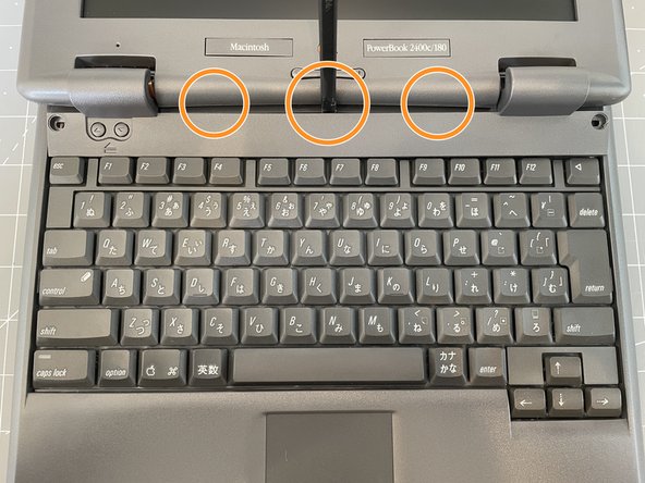

  3. PowerBook 2400c Disassembly, Remove the top plate: passo 3, immagine 1 di 2 PowerBook 2400c Disassembly, Remove the top plate: passo 3, immagine 2 di 2
    • Using a plastic spudger, pop the hinge clips forward by carefully squeezing them forward.
    • With a spudger, push in the two plastic clips in the front behind the F3 and F12 keys.
    • After the hinge covers are loostened, insert your spudger and loosen the rest of the top clips across the back.
    • The top plate should come free.

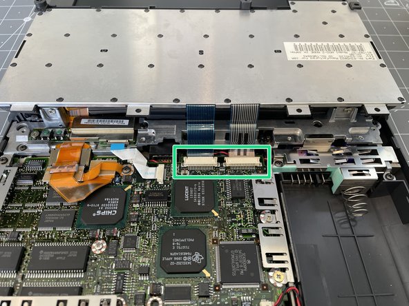

  6. PowerBook 2400c Disassembly, Remove the keyboard: passo 6, immagine 1 di 3 PowerBook 2400c Disassembly, Remove the keyboard: passo 6, immagine 2 di 3 PowerBook 2400c Disassembly, Remove the keyboard: passo 6, immagine 3 di 3
    • Remove 3 x silver 3mm phillips screws from the top of the keyboard.
    • Remove 3x black 8mm screws from the bottom.
    • Lift the back of the keyboard (the end by the screen) slightly and move it forward to release it from the metal clips at the bottom left. You can then flip the keyboard over and set it on top of the screen.
    • Using a spudger, release the clips from the keyboard connectors and remove the cables from the connectors.
    • You can now remove the keyboard and set it aside.

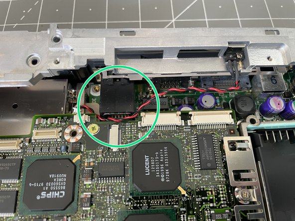

    • Using a spudger, disconnect the display sleep switch from the board.
    • Remove the 3 black 8mm phillips screws from the outside of the top frame.
    • Remove the 1 black 22mm phillips screw from the top right of the top frame.
    • Remove the 1 black 14mm phillips screw from the middle left of the top frame.
    • Remove the 1 black 4mm phillips screw from the left of the top frame.
    • Lift off the top frame, being careful to unravel the sleep switch cable from around the SCSI port.

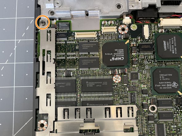

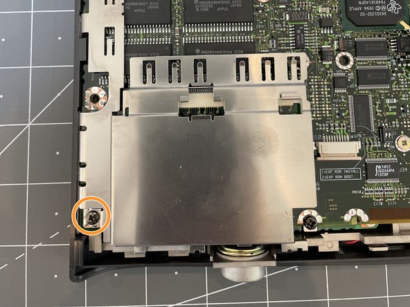

    • Remove the 2 silver 3.5mm phillips screws from the shielding on the right of the board. You can then remove and set aside the shielding.
    • Remove the 3 remaining silver 3.5mm phillips screws from the system board.
    • Remove the 2 black 16mm phillips screws from the right of the board.
    • Remove the 1 silver 14mm phillips screw from the center of the board.

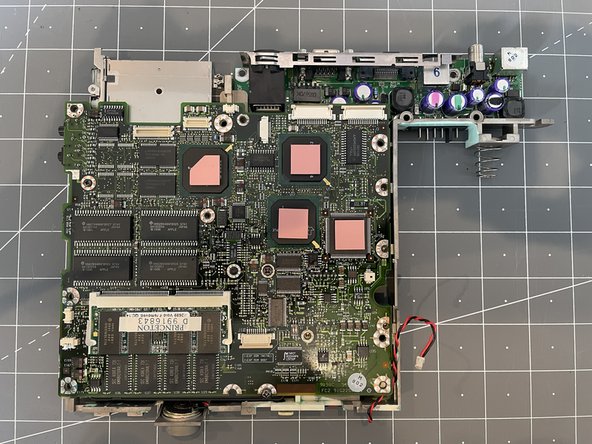

    • The main system board is connected to the daugter board below. Using a spudger where indicated to gently coax the board free from the connector below.
    • You can now lift the main board out of the case.
  13. PowerBook 2400c Disassembly, Remove hard drive: passo 13, immagine 1 di 2 PowerBook 2400c Disassembly, Remove hard drive: passo 13, immagine 2 di 2
    • Remove the 2 black 3.5mm phillips screws from the bottom side of the board.
    • The hard disk will only be connected by the IDE connector. Support the hard drive with your hand while turning the board over.
    • Gently, but firmly remove the hard drive from the IDE connector by wiggling back and forth slightly and pulling back toward the side of the board.
    • If you have made it this far, DO NOT STOP HERE. It's virtually impossible to re-seat the system board correctly without disassembling further. Proceed to the next step!

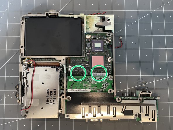

  14. PowerBook 2400c Disassembly: passo 14, immagine 1 di 1
    • Remove the single black 16mm phillips screw holding the plastic assembly to the bottom case.
    • Lift the front of the board (closest to you) to pull the assembly out of the case, making sure clear the ports in the back.

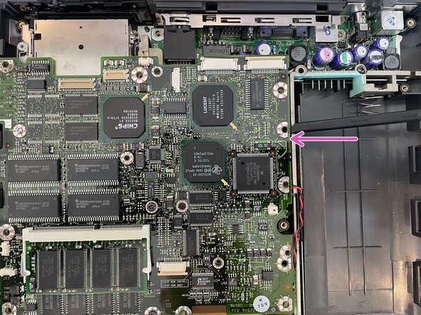

  15. PowerBook 2400c Disassembly, Re-seating the system board: passo 15, immagine 1 di 3 PowerBook 2400c Disassembly, Re-seating the system board: passo 15, immagine 2 di 3 PowerBook 2400c Disassembly, Re-seating the system board: passo 15, immagine 3 di 3
    • The plastic frame isn't very sturdy. Be sure to support it appropriately while you're working with it.
    • Place the system board on top of the assembly so the PCMCIA slot is to the left of the ports.
    • Carefully flip the assembly over.
    • While supporting the back, gently apply pressure to the highligted area to re-seat the boards. You should feel a positive fit.
