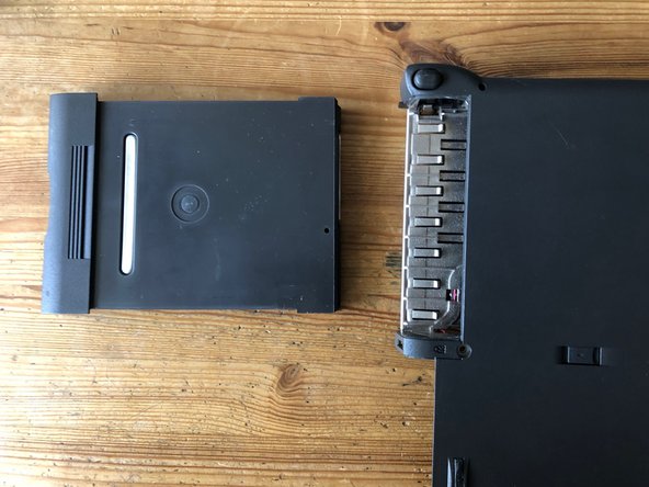

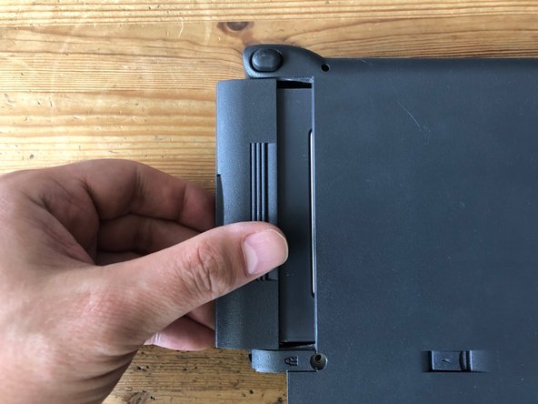

  1. PowerBook 190cs teardown, battery removal: passo 1, immagine 1 di 2 PowerBook 190cs teardown, battery removal: passo 1, immagine 2 di 2
    • push the battery latch to the right to release it, then pull it out.

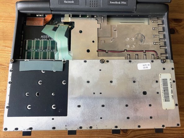

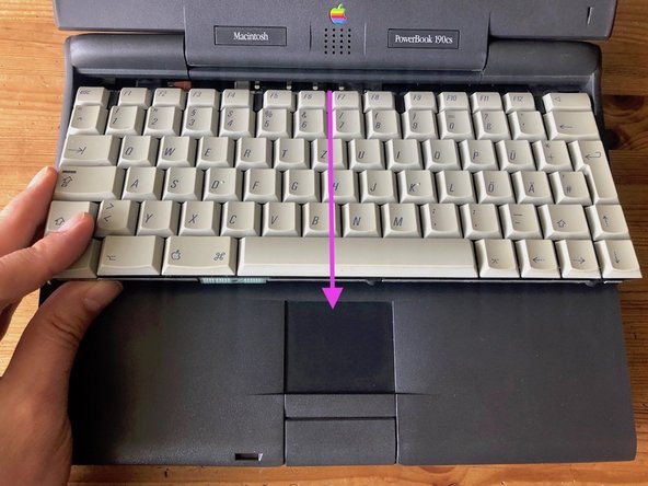

  4. PowerBook 190cs teardown, keyboard removal: passo 4, immagine 1 di 3 PowerBook 190cs teardown, keyboard removal: passo 4, immagine 2 di 3 PowerBook 190cs teardown, keyboard removal: passo 4, immagine 3 di 3
    • use a spudger or similar flat tool to carefully lift up the keyboard.
    • on top of the keyboard are several flat plastic noses that keep it secured. Pull the keyboards towards you to release it from the case. Then flip it over. Notice its ribbon cables still are attached to the mainboard.

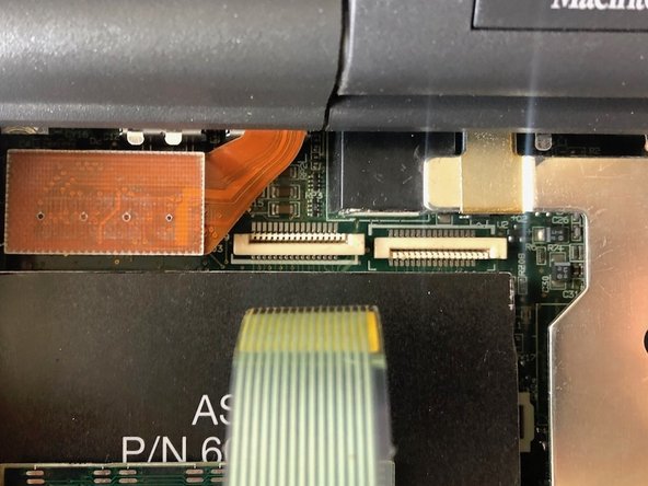

  5. PowerBook 190cs teardown, keyboard ribbon cable removal: passo 5, immagine 1 di 3 PowerBook 190cs teardown, keyboard ribbon cable removal: passo 5, immagine 2 di 3 PowerBook 190cs teardown, keyboard ribbon cable removal: passo 5, immagine 3 di 3
    • locate the keyboard ribbon cable connectors on top left in the case. Carefully lift up the top part of the ribbon cable release: To not brake it, I do this in four small steps.. a few millimeters on the left and then on the right side, repeat untill the cable can be pulled out easily. Use good light.
    • to release the two flat keyboard ribbon cables use a slim tool, here I used an angled tweezer.

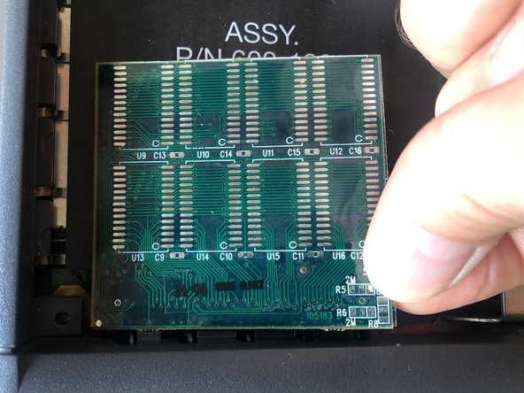

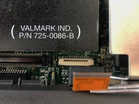

  6. PowerBook 190cs teardown, RAM card removal: passo 6, immagine 1 di 2 PowerBook 190cs teardown, RAM card removal: passo 6, immagine 2 di 2
    • if your machine has an additional expansion RAM card installed, carefully pull it out sideways with your fingernail to remove it.

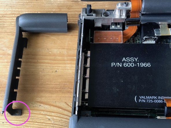

  8. PowerBook 190cs teardown, removal of monitor end caps: passo 8, immagine 1 di 2 PowerBook 190cs teardown, removal of monitor end caps: passo 8, immagine 2 di 2
    • do the same for the left side. Notice that at the bottom end they have plastic screw hole latches attached, so do not brake it.

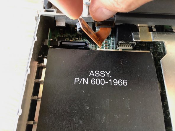

  9. PowerBook 190cs teardown, trackpad ribbon cable removal: passo 9, immagine 1 di 3 PowerBook 190cs teardown, trackpad ribbon cable removal: passo 9, immagine 2 di 3 PowerBook 190cs teardown, trackpad ribbon cable removal: passo 9, immagine 3 di 3
    • to remove the trackpad ribbon cable, carefully lift up the top release latch with a fine tool, here I used an angled tweezer again ( as in the steps above for the keyboard ribbon cables).

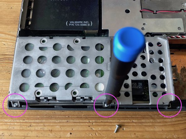

  11. PowerBook 190cs teardown, hard disk case removal: passo 11, immagine 1 di 3 PowerBook 190cs teardown, hard disk case removal: passo 11, immagine 2 di 3 PowerBook 190cs teardown, hard disk case removal: passo 11, immagine 3 di 3
    • to remove the hard disk case from the case, unscrew the three plastic screws to the front of the case. Then pull it up.

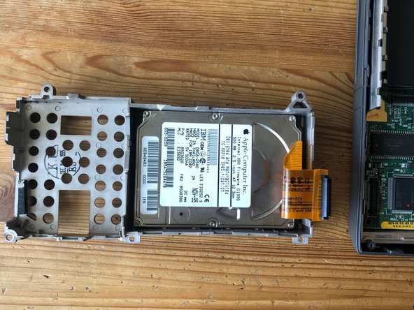

  12. PowerBook 190cs teardown, hard disk cage removal: passo 12, immagine 1 di 3 PowerBook 190cs teardown, hard disk cage removal: passo 12, immagine 2 di 3 PowerBook 190cs teardown, hard disk cage removal: passo 12, immagine 3 di 3
    • carefully lay the the hard disk cage on its back to the left of the powerbook case, because the hard disk still is attached to the mainboard. Then pull out the connector of the hard disk.

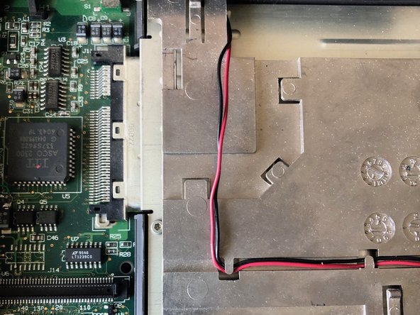

  18. PowerBook 190cs teardown, LED cable removal: passo 18, immagine 1 di 3 PowerBook 190cs teardown, LED cable removal: passo 18, immagine 2 di 3 PowerBook 190cs teardown, LED cable removal: passo 18, immagine 3 di 3
    • Locate the LED cable on top of the floppy drive. Unplug it from its connector on the board.
    • In order to have an easier access for the motherboard removal I additionally secured the cable with a piece of tape.
  19. PowerBook 190cs teardown, floppy drive removal: passo 19, immagine 1 di 3 PowerBook 190cs teardown, floppy drive removal: passo 19, immagine 2 di 3 PowerBook 190cs teardown, floppy drive removal: passo 19, immagine 3 di 3
    • push the little securing lever at the bottom of the case towards the drive. Then grab the drive and pull it out of the case. Sometimes it takes a little force.

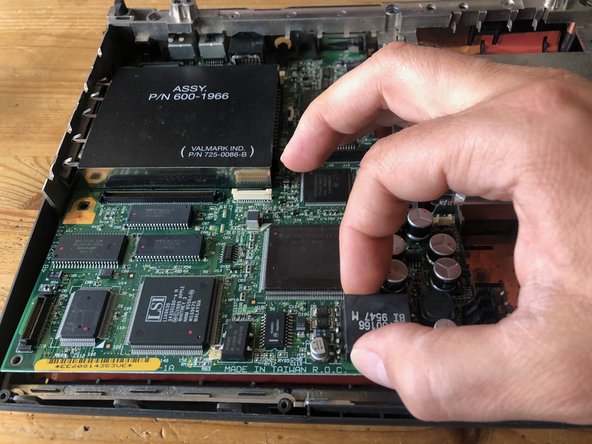

  20. PowerBook 190cs teardown, mainboard removal: passo 20, immagine 1 di 3 PowerBook 190cs teardown, mainboard removal: passo 20, immagine 2 di 3 PowerBook 190cs teardown, mainboard removal: passo 20, immagine 3 di 3
    • the mainboard is now free to be pulled out. It is not too difficult but you have to be careful. I grabbed on the most stable components like the PCMCIA cage and carefully pulled it towards me. In order to free the left metal fingers of the PCMCIA cage you have to slightly pull the casing outwards a little bit, otherwise they get stuck underneath.
    • as soon as the PCMCIA cage is free from the case you can pull the board out.
