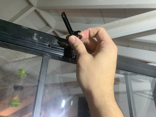

    • Remove the old piston from its current position.
    • Pull out two pins—one on both sides of the piston.

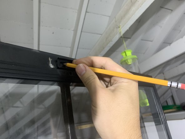

    • Use the cordless drill to remove the old bracket attached to the door trim.
    • Improperly placed brackets can cause the piston to malfunction.

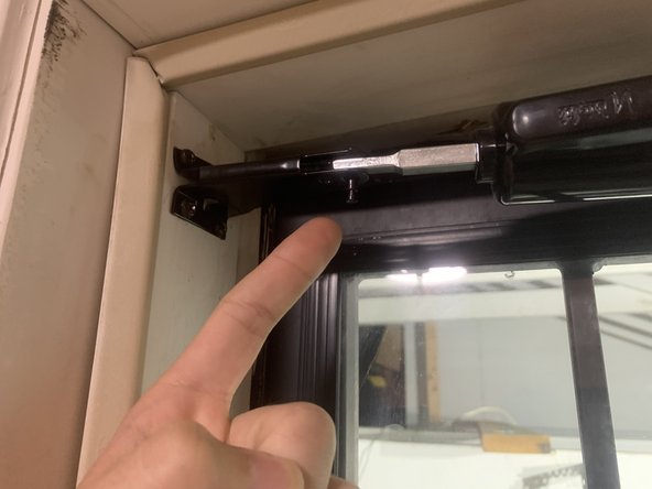

    • Remove the bracket that is attached to the storm door.
    • There are only 1-2 screws holding this one in, being that it is a metal door. These screws are shorter and have a tighter thread pattern.

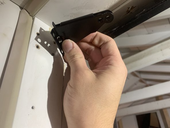

    • Lay out the placement of the new brackets.
    • The template for new brackets can be found in the instruction manuals given with the new hardware. Be sure to pay attention to the type of door it is being installed on.

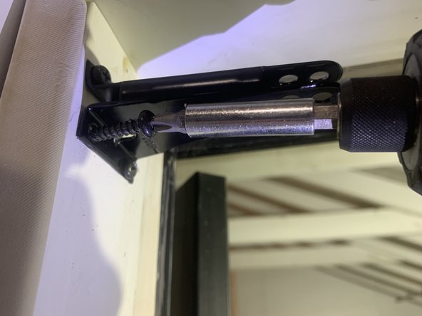

    • Once marked, use a cordless drill with a Philips #2 bit to drive the four 1 1/2" screws into the bracket into the trim.
    • Ensure that the bracket is roughly square to the naked eye.
