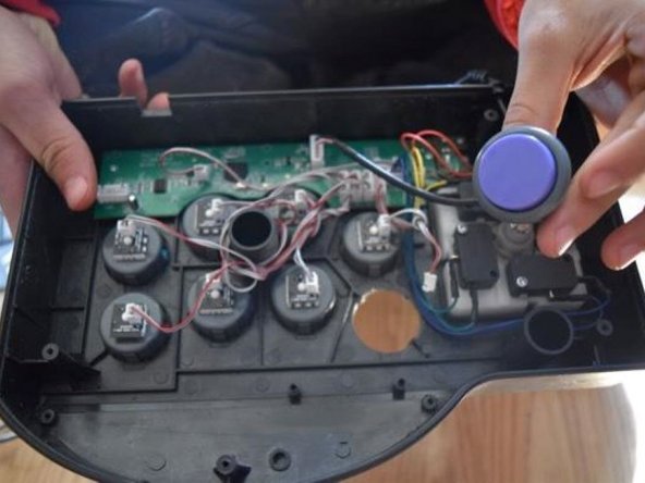

    • Place the PXN Arcade Stick on a flat surface.
  2. PXN Arcade Stick Button Replacement: passo 2, immagine 1 di 1
    • Turn the controller upside down.
    • Remove the four screws from the bottom of the device.
  3. PXN Arcade Stick Button Replacement: passo 3, immagine 1 di 1
    • Set the back cover aside, being cautious of the cable connected to the motherboard.
    • Unplug the controller converter plug.
  4. PXN Arcade Stick Button Replacement: passo 4, immagine 1 di 1
    • Unplug the button you wish to replace.
  5. PXN Arcade Stick Button Replacement: passo 5, immagine 1 di 2 PXN Arcade Stick Button Replacement: passo 5, immagine 2 di 2
    • Push in and down on the button components.
  6. PXN Arcade Stick Button Replacement: passo 6, immagine 1 di 2 PXN Arcade Stick Button Replacement: passo 6, immagine 2 di 2
    • Use a spudger to push in and up on the button housing.
  7. PXN Arcade Stick Button Replacement: passo 7, immagine 1 di 1
    • Line up the replacement button with the socket and push down.
  8. PXN Arcade Stick Button Replacement: passo 8, immagine 1 di 1
    • Push the new button down into the back case of the controller.
