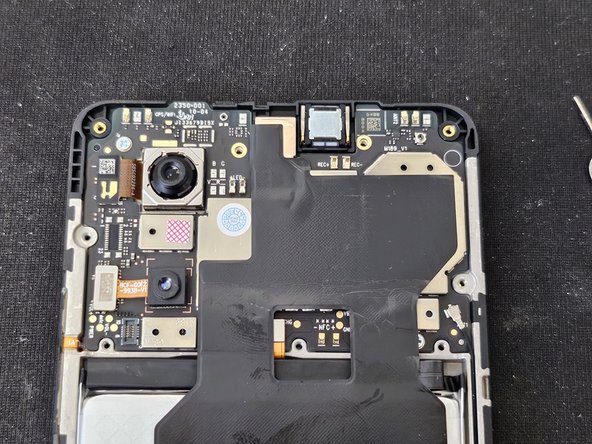

  6. Oscal Tiger 12: Teardown, Final connectors and motherboard screws: passo 9, immagine 1 di 3 Oscal Tiger 12: Teardown, Final connectors and motherboard screws: passo 9, immagine 2 di 3 Oscal Tiger 12: Teardown, Final connectors and motherboard screws: passo 9, immagine 3 di 3
    • This black cover (thermal diffusor?) is glued onto the battery with a very thin layer of adhesive.
    • Remove the cameras from the motherboard, then lift the black cover over the motherboard to expose the battery and LCD connectors.
    • Disconnect them, then remove the 2 screws that hold in the motherboard.
    • I used to mark these (to remember where they go), but I've noticed they're pointed to by 2 very small arrows on the motherboard.
