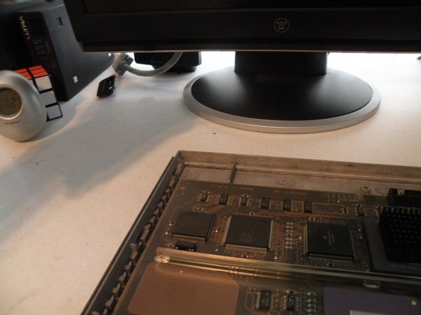

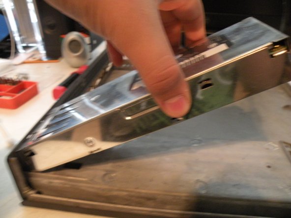

    • Turn the NeXTStation around, and remove this screw:
    • Then, lift the top cover of the computer. This will reveal the guts.

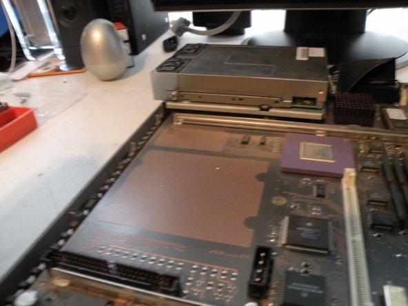

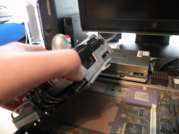

  4. NeXTstation Teardown: passo 4, immagine 1 di 3 NeXTstation Teardown: passo 4, immagine 2 di 3 NeXTstation Teardown: passo 4, immagine 3 di 3
    • Then remove this screw.
    • Once the screw is removed, pivot the drive up on a 45 Degree angle, then slide it out.
  5. NeXTstation Teardown: passo 5, immagine 1 di 1
    • The Hard Drive & Caddy

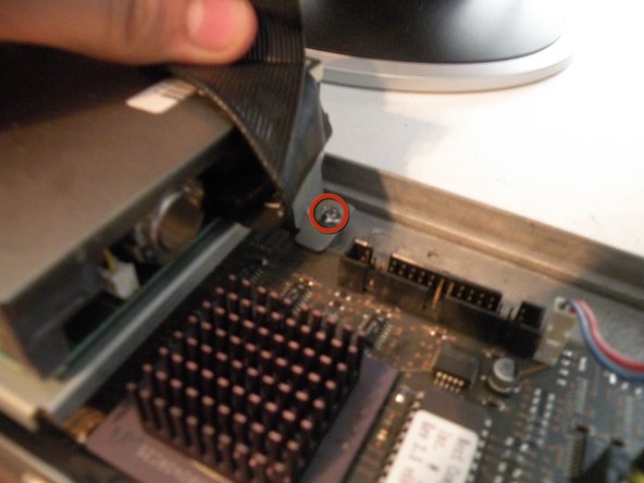

  6. NeXTstation Teardown: passo 6, immagine 1 di 3 NeXTstation Teardown: passo 6, immagine 2 di 3 NeXTstation Teardown: passo 6, immagine 3 di 3
    • Removing the floppy disk drive:
    • The NeXTStation uses a non-standard 2.88MB 3.5" floppy drive, though it uses the standard floppy connector.
    • Remove the floppy cable.
    • Then, remove this screw.
  7. NeXTstation Teardown: passo 7, immagine 1 di 3 NeXTstation Teardown: passo 7, immagine 2 di 3 NeXTstation Teardown: passo 7, immagine 3 di 3
    • Then, just like the hard drive, pivot the drive up 45 degrees, and pull it out.

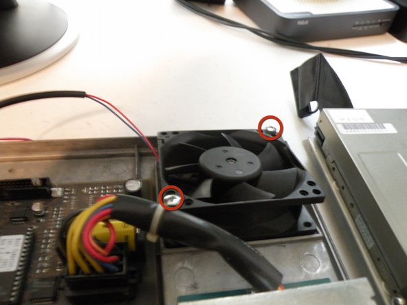

    • Removing the fan:
    • Remove this connector.
    • Remove these screws.
    • Remove the fan.

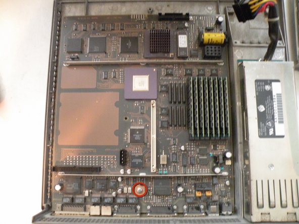

    • Removing the logic board:
    • Remove the power supply connector. Just lift it straight up, and it should come free.
    • Remove this screw.
  10. NeXTstation Teardown: passo 10, immagine 1 di 3 NeXTstation Teardown: passo 10, immagine 2 di 3 NeXTstation Teardown: passo 10, immagine 3 di 3
    • Lift the end of the logic board(away from the ports), and slide it away from the ports.
    • Now, set the board aside.

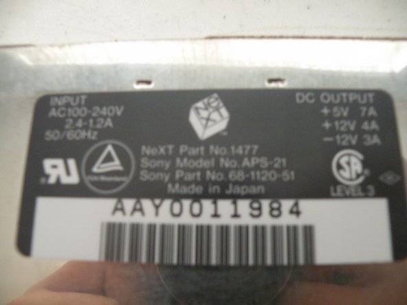

  11. NeXTstation Teardown: passo 11, immagine 1 di 3 NeXTstation Teardown: passo 11, immagine 2 di 3 NeXTstation Teardown: passo 11, immagine 3 di 3
    • Power Supply:
    • Lift the power supply up, and out.

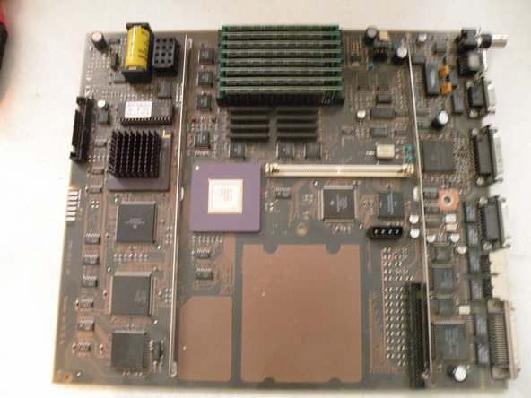

    • The Logic Board Overview:
    • The Board has a 25Mhz Motorola 68040 CPU, This board features a ton of chips for something made nearly 20 years ago.
    • The CPU: Motorola XC68040RC25
    • The Co-Procesor: MB610313
    • Motorola Chips
    • Intel Chips
    • AMD Chips (Intel and AMD In the same computer?)
    • Fujitsu Chips

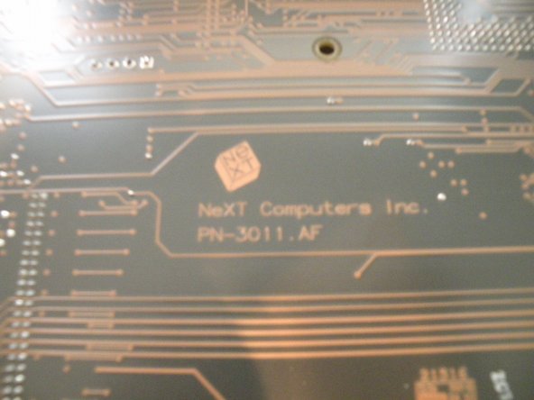

  13. NeXTstation Teardown: passo 13, immagine 1 di 3 NeXTstation Teardown: passo 13, immagine 2 di 3 NeXTstation Teardown: passo 13, immagine 3 di 3
    • Made in the USA, you don't see this anymore.
    • The Serial #
    • Looks like my NeXTStation came from WilTel.
    • It is model # N1100

MB610313 - ICP (Integrated Channel Processor). Basically DMA on steroids for almost all of the main sub components of the system. I believe that the cube, or at least the 25Mhz 030/040 cubes, had two of these.
