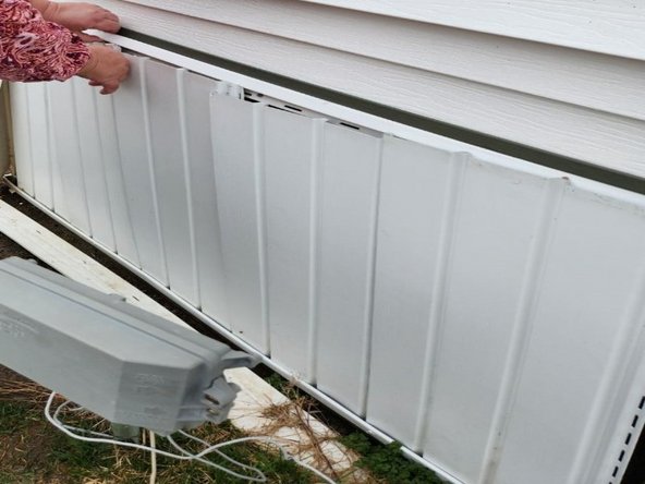

    • Find the missing pieces or order them from a Mobile Home supply company or Amazon, making sure they are the correct height.
    • Once you have the missing pieces, you can take each piece and start sliding them together as in Image 2.
  2. Mobile Home Skirting Replacement: passo 2, immagine 1 di 3 Mobile Home Skirting Replacement: passo 2, immagine 2 di 3 Mobile Home Skirting Replacement: passo 2, immagine 3 di 3
    • Start by sliding the pieces together (there are what looks like a curved piece on the end of each piece).
    • Once attached to each other, ensure the bottom is slid into the bottom track.
  3. Mobile Home Skirting Replacement: passo 3, immagine 1 di 3 Mobile Home Skirting Replacement: passo 3, immagine 2 di 3 Mobile Home Skirting Replacement: passo 3, immagine 3 di 3
    • Once the panels are secure in the bottom track, you will need to lift the upper track a little.
    • After lifting the upper track upward, you will slide the skirting in under it.
    • After pushing it into the upper track, you will hear a click and it should be secure in the top track.
  4. Mobile Home Skirting Replacement: passo 4, immagine 1 di 1
    • Once secured in the lower and upper tracks, attach it to the existing panel.
  5. Mobile Home Skirting Replacement: passo 5, immagine 1 di 1
    • You can secure the panels further by putting screws in the top of the panel if needed. This will help further in case of wind storms.
