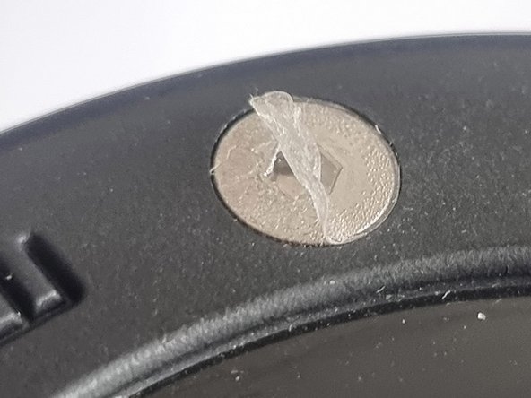

  3. Minirig Battery Replacement, Removing the feet to gain access to the screws: passo 3, immagine 1 di 2 Minirig Battery Replacement, Removing the feet to gain access to the screws: passo 3, immagine 2 di 2
    • The clear rubberised feet are now removed, but there is an adhesive layer over the screw heads that must be peeled off to expose the hex head screw sockets.

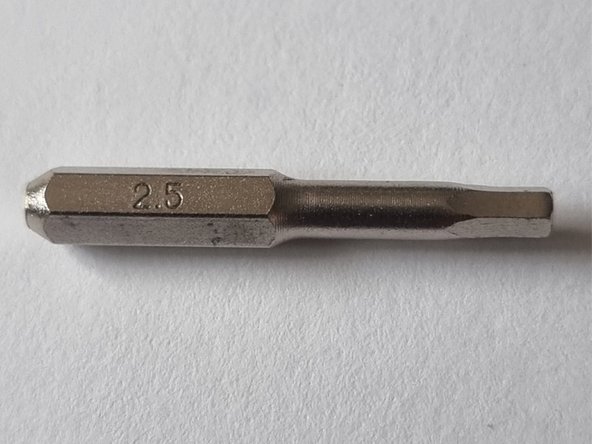

  4. Minirig Battery Replacement, Removing the screws: passo 4, immagine 1 di 2 Minirig Battery Replacement, Removing the screws: passo 4, immagine 2 di 2
    • Use a 2.5mm hex tool to remove the lovely stainless screws.
    • An Ifixit driver works very nicely :)

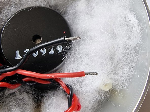

  7. Minirig Battery Replacement, Disconnecting the original battery: passo 7, immagine 1 di 1
    • The battery is wired to a multi connector which also has wires to the speaker and charging socket. It's not possible to separate the battery wires from this connector without a special tool and an unnecessary amount of bother.
    • So we'll snip the battery wires to remove the battery and join our new battery onto those later.
    • Be sure to cut the wires one at a time so you don't cause a short-circuit.
    • It's best to cut them close to the battery so you have a decent amount of wire still attached to the main Minirig body.

  9. Minirig Battery Replacement, Prepare the battery wires: passo 9, immagine 1 di 2 Minirig Battery Replacement, Prepare the battery wires: passo 9, immagine 2 di 2
    • Strip about 4mm of insulation from the end of each wire that's coming from the main Minirig circuit board.
    • Tin the ends of the wire by applying a small amount of solder to the exposed metal.
    • The Minirig itself is now ready to have its new battery attached.

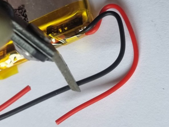

  11. Minirig Battery Replacement, Prepare the new cells: passo 11, immagine 1 di 3 Minirig Battery Replacement, Prepare the new cells: passo 11, immagine 2 di 3 Minirig Battery Replacement, Prepare the new cells: passo 11, immagine 3 di 3
    • Prepare the cells by cutting off the supplied connector from each (if supplied with one).
    • For safety, to avoid short circuiting the cells, be sure to cut each wire individually.
    • Stagger the cuts so the remaining wires are different lengths and less likely to touch each other during the assembly of the pack.

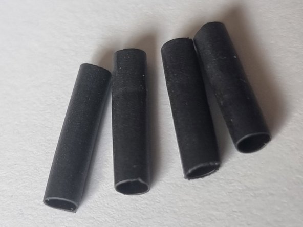

  12. Minirig Battery Replacement, Prepare the heatshrink: passo 12, immagine 1 di 2 Minirig Battery Replacement, Prepare the heatshrink: passo 12, immagine 2 di 2
    • We'll need 4 lengths of heatshrink, each about 15mm long and with an internal diameter of around 3.5mm

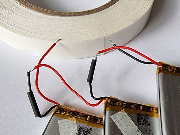

  13. Minirig Battery Replacement, Connect the 3 cells in series: passo 13, immagine 1 di 1
    • Each battery is wired to the next like this.
    • First, tin the ends of the wires by applying a small amount of solder.
    • Don't forget to slide the heatshrink on before joining the wires together.
    • Then hold the wires that you are joining next to each other while applying heat to melt the solder and permanently join the wires.
    • Positive goes to negative, leaving a red wire at one end of the chain and black at the other. This is wiring the cells in series, which increases the voltage. So here we have 3 3.7 Volt cells wired in series, giving us a nominal 11.1 V battery pack.
