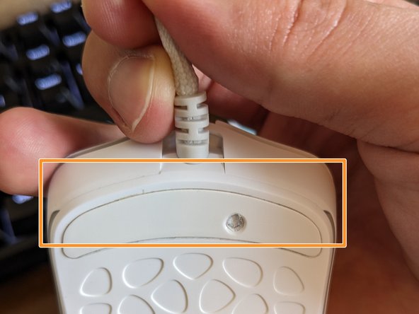

    • Start by removing the 2 screws on the bottom of the mouse.
    • You can either remove the rear skate and re-adhere it afterwards or use a 9/64" or 3.5mm drill bit to reveal the holes
    • If you opt to drill a hole through the skate, pressing hard in the area will reveal a indentation where the hole lies
