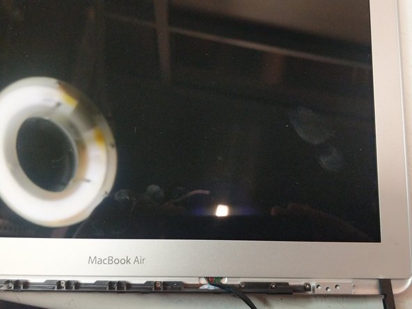

  3. MacBook Air 13" Bluetooth/Wifi Antenae /Webcam /Display Cable/Hinge Replacement, Heat and Remove Bezel: passo 3, immagine 1 di 3 MacBook Air 13" Bluetooth/Wifi Antenae /Webcam /Display Cable/Hinge Replacement, Heat and Remove Bezel: passo 3, immagine 2 di 3 MacBook Air 13" Bluetooth/Wifi Antenae /Webcam /Display Cable/Hinge Replacement, Heat and Remove Bezel: passo 3, immagine 3 di 3
    Attrezzo utilizzato in questo passaggio:
    • Remove the gasket that runs along the perimeter of the display. You can use a spudger to pry up the bezel and tweezers to pull it out.
    • Be careful to not tear your gasket
    • Apply Heat to loosen the adhesive, in a pinch you do not necessarily need it; but it always helps with adhesives.
    • Begin Prying from the right corner as pictured.
    • The Webcam and Antennae are under the left side of the bezel.

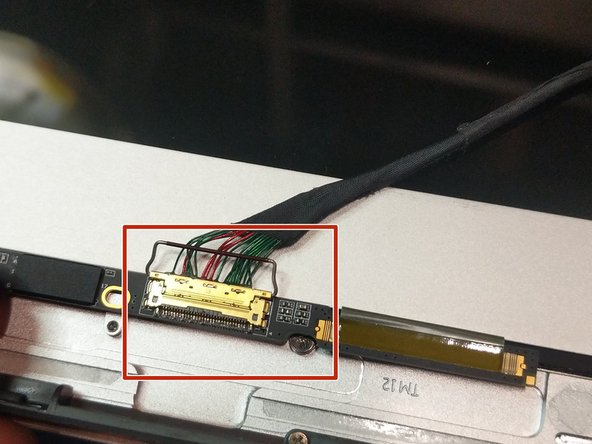

    • Remove the two PH000 screws holding in the LCD board in
    • To replace the display connection you can open the retaining latch and disconnect the cable.
    • If you're replacing the Webcam/ Wifi Antennae Continue on to the next step.

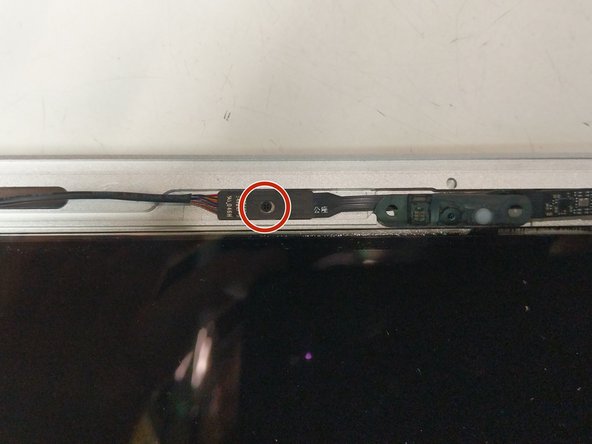

  5. MacBook Air 13" Bluetooth/Wifi Antenae /Webcam /Display Cable/Hinge Replacement: passo 6, immagine 1 di 3 MacBook Air 13" Bluetooth/Wifi Antenae /Webcam /Display Cable/Hinge Replacement: passo 6, immagine 2 di 3 MacBook Air 13" Bluetooth/Wifi Antenae /Webcam /Display Cable/Hinge Replacement: passo 6, immagine 3 di 3
    • If you're just replacing your Webcam skip this step
    • Remove the three T8 Torx screws
    • Remove the PH000 screw
    • Flip the board over and disconnect it.
    • The Wifi / Bluetooth / Webcam cable can now be removed and replaced.
  6. MacBook Air 13" Bluetooth/Wifi Antenae /Webcam /Display Cable/Hinge Replacement: passo 7, immagine 1 di 1
    • Disconnect your webcam connection,
    • The webcam is held in by the bezel and a small bit of adhesive on the backside of the webcam
